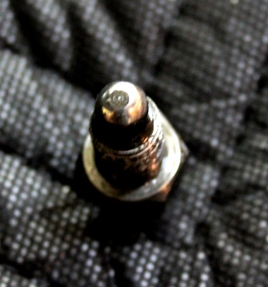

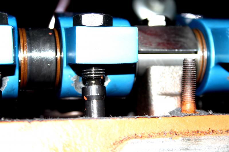

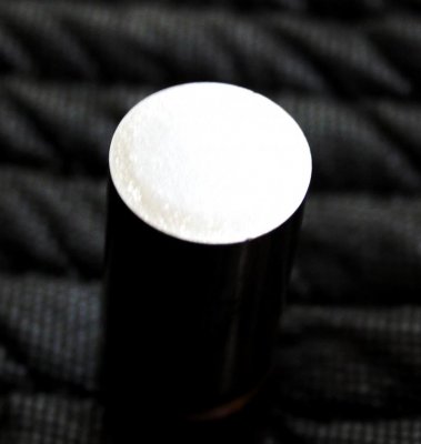

Here is what I am dealing with. These are Proform pushrods for the rockers that are on the 440. You can see that the intake rod got crushed against the hydraulic lifter. The exhaust rod did the same. I suspect I have another exact problem on another cylinder because the lash is .006 and .010 on each rod. Problem is that I can only find these "cupped" rods from Jegs and Northern and Keystone. They are special order and take 2-3 weeks at best. I thought pushrods were solid. Just my feeling. Why are they hollow? Certainly not for weight reduction I would think. Cooling? Or just a crappy weak design?
I have little experience with a HP engine. I have restored Alfa Romeos for years. Got out of those and wanted a muscle car. If it wasn't for all of the members on this terrific board, I'd be on my own and learning on the job and by trial and error. The confidence I get from you members makes me comfortable in tearing into the big stuff. I bow to you and thank you for the learning experiences.
Here are photos of the rod. The other rod is actually worse, it is worn "crushed" down to the rod. The tip is totally gone. Amazing that the lifter seems to be untouched. The metal "filings" were in the "cup" on top. I simply vacuumed it out. The lifter moves freely. Should I remove them and inspect them? Is that an easy thing to do? Any precautions?

Dang, we are gonna need to think this out...
The whole reason behind hydraulic lifters is so you have no lash...
Maybe the valve lash was adjusted without the lifters being pumped up...
When the lifters got oil they pumped up, took up all the lash, and wrecked the pushrods.
I worry that you may even have a flat cam...
If the pressure was enough to collapse the pushrod tip...
Imagine the pressure on the cam lobes...
Those type pushrods should be common...
They are cupped on one end for adjustable rockers...
Are you sure you have hydraulic lifters?
I'm not trying to be a smart a55 or anything...
I just want to help you get your engine running with the least headache...
Maybe someone more current will answer...
The hollow pushrods are for lubrication...
I'm just curious about the pushrods & adjustable valve train...
I think you should pull the lifters, keep them in order, don't mix up the parts.
Keep all of #1 with number one, #2 with number two and so on.
This will help when diagnosing, and in case you reuse parts they can go back in the correct place.

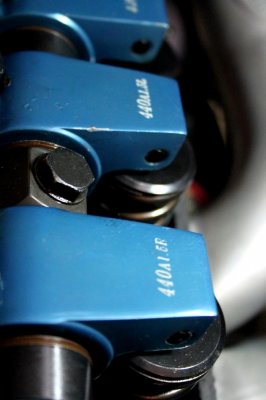

Maybe someone used the adjustable rockers on a hydraulic cam.
If they set lash like a solid cam, when the lifters pumped up, they would be much too tight...and perhaps cause the failure...
I'm only grasping at pushrods here...
If you could show us a picture of the lifters, and the adjustable rockers, maybe we can narrow things down...

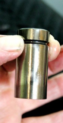

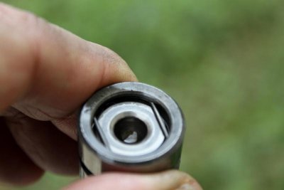

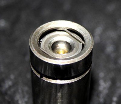

I am concerned about one thing. Because of the filings that came from the pushrods, do you think I should take the lifters apart and clean them. Not sure I want to , but if that is something that can go wrong, I'll do it. Now here is something else, I don't think I have any pushrods that do not show wear on the ball. Some worse than others. It looks as if the ball (a different material than the tube) wore down, in some cases there were ragged chips off the flattened edge, and in half the cases the rod was worn down around what was left of the ball. As though the ball did not fit the radius in the top of the lifter, or the angle of the rod caused the sidewall to wear down. All the cups on the top of the rod looked ok, but the ball on the adjuster was flattened or showed signs of wear in over half the adjusters. The other half looked untouched.

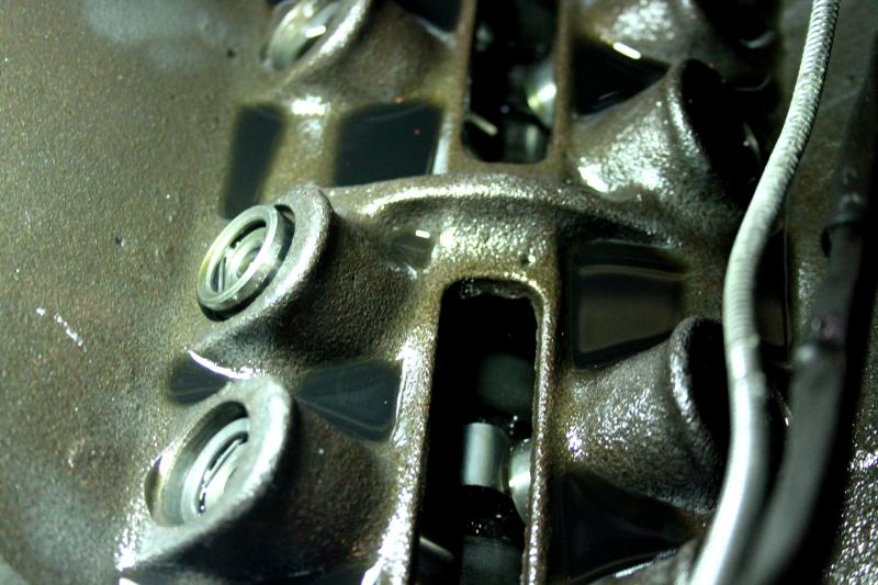

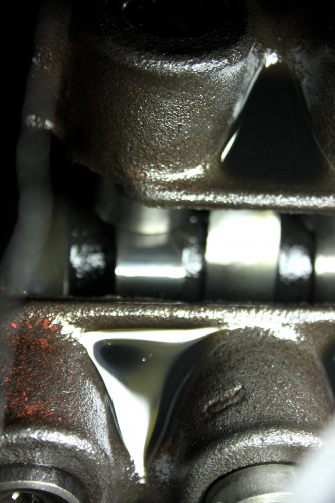

I know how much time this is taking me and I feel a bit guilty of soliciting all of your comments and advise. ...Pysyko, thank you for your interest. I took some more photos at your request. Let me know if more help. I don't know how many I am allowed to put on one reply, but I guess I'll find out.

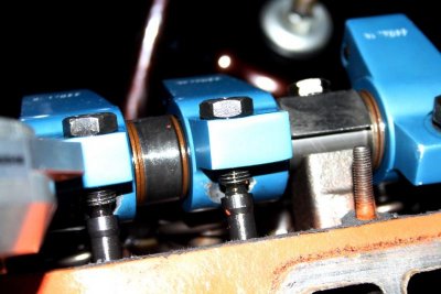

Just one or tow more observations. I am out of adjuster threads at 0 lash. Either that is due to wear, or due to the pushrods being too short to begin with. One more, look at the cone shape on the top of the lifter. I believe it was designed that way so there would be no interference and subsequent wear. Correct? I don't think it wore that way from the angle the rod takes to enter it.???
Finally, while I had this engine down to camshaft, I looked for some nomenclature to determine what it was I had with out having to pull the engine just to read the end of the shaft. The grind showed.......CWC EP45 I found CWC but I have found nothing on the EP 45. Any ideas? Maybe I'll start with a new topic. rocker  brand .jpgadjustment at 0 lash.jpgno adjustment left at 0 lash.jpglifter Wear or design.jpgLifter from worst cyl.jpgview of lifter up close.jpgmost out of lash lifter no wear.jpgball on end of adjuster flattened.JPGlifter on cam showing lobes.jpgcam and lifter on worst cyl.jpg

The wear on the adjusters & the broken push rods to me suggest the lash was non existent. And when the lifters pumped up, there was no room for the tight pushrods... I'm sure the only reason the damage isn't worse is the engine was shut down.

It almost looks like a newly installed adjustable rocker set ,installed incorrectly, or at least adjusted incorrectly.

Also, you don't want to use any parts that are flaking, or even possibly damaged...
And if you clean the lifters one at a time, it could be done... Better safe than sorry, especially with loose shavings inside an engine. The filter will catch them, but they still need to make it to the pan...
I am concerned about the cam as well... On initial startup you need the lifters to spin in the bore immediately or risk a flat lobe. I don't think many lifters we're spinning. But maybe the engine didn't run long?
FYI the lobes on the cam are ground in a way that that cause the lifters to spin in their bore.
It's so important, it's built in.

The REASON that I said that the pushrods MAY be too short is because of the amount of threads showing under the rocker arms. To clarify what type of lifters you have (At least we DO know that they're NOT roller lifters...lol) remove the snap ring from one of the lifters, turn it upside down on a rag and see what falls out. A solid lifter will have only a cup portion that will not compress; that is, the cup sits on a shelf and the snap ring holds it in place. Hopefully, you've figured this all out by now and the motor is running fine. Good luck...
