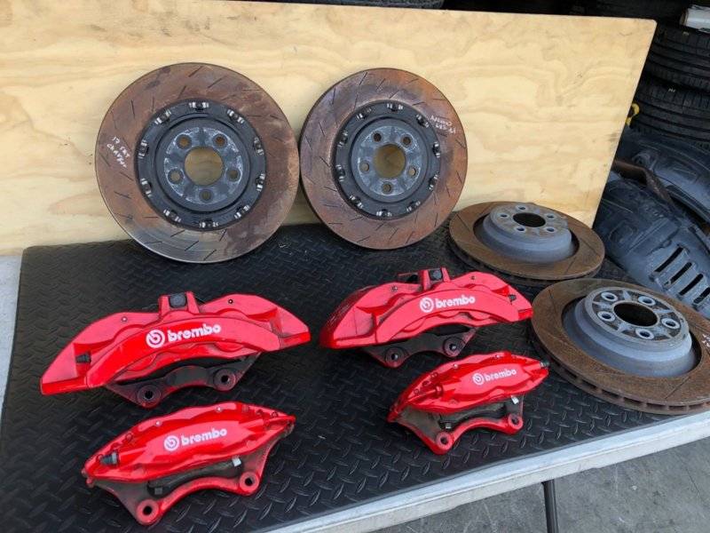

Hi guys,
Just curious if anyone has fitted up a set of the late model Challenger brakes to their old B body?
I see that I can buy an used set for a reasonable price - but don't know if they'll even fit.
Thoughts?

Nope, not without some fab. At the very least you would need custom caliper brackets and somehow have to find a way to adapt those rotors to your hubs.
Once that happens, you’d then need some big wheels (18”-20” looks like) to fit around those babies.

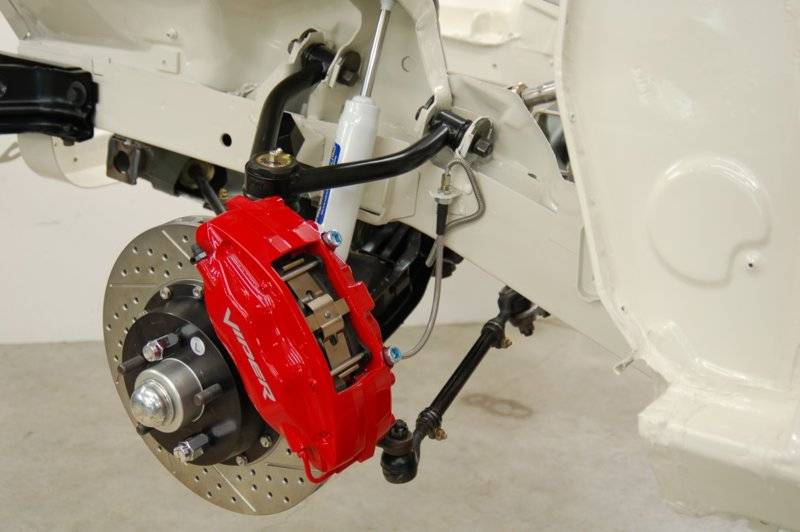

They'll fit if you know what you are doing. Of course, if you knew how to do it I suppose you wouldn't be asking the question. I have Porsche twin turbo brakes on the front of my '65 Coronet and I have Viper brakes on the front of my Duster.

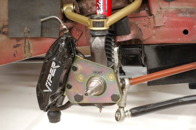

The biggest problem with that swap is the ear mount calipers. Ear mount calipers are a bit of a pain to swap onto disc brake knuckles. It would most likely be easier to put them on drum brake knuckles. I used to make a kit to bolt Viper calipers on to the late model A body drum knuckle. It wasn't a very complex adapter and I'm sure something similar would work with those Charge calipers.
Ahhh...The Red Brick!
A friend of mine owns the car now. He lives near Sacramento, CA.
Regarding drum knuckles...I have a pair but do not know if they are the right ones. What is the height of the knuckle and the inner wheel bearing size of the proper knuckle? I have some here but I don't know if they are for an A body or a B.
I guess the upper ball joint hole would tell the story, right?
Wouldn't you know it - I tossed my old drum spindles. I'd be interested if you have a set for a B body!
