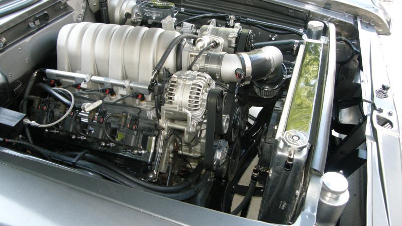

Kickin' the idea around of doing a 5.7 stroked to 392 or a 6.1 stroked to 426. Doing either one will cost, and my money tree is going dorment, lol!! I have an extra set of 5.7 heads and when I'm done with my dads 70 challenger rt, he's gonna get the cam of my choice so I have time but the itch is starting to get to me. My current set up is doing great, but more power is always welcome. Once the new engine is done then the trans is getting rebuilt to handle the new power level.

Well I think I'm gonna use a new 6.1 block and crank, get some forged pistons, new stock rods and have my extra set of 5.7 heads gone thru, then have them milled either .030 or .050. The .030 will give me around 10.3 to 1 and the .050 will be around 11.0 to 1 so with the right tune hp at the wheels should be about 430-450ish. Of course the right cam has to be picked along with the tune so it could go up or down.....now the hunt is onfor some parts, hehehehe!!

Plans are in the works for a 5.7 hemi 392 stroker. Got another 5.7 block and have found a crank, so I'm looking for rods/pistons, and this is gonna run 11 to 1 compression. I have another set of heads that will "rubbed, and ported" with love. I'm looking for around 480ish to the wheels, and my luck, the trans will not like it, lol. But I have taken that into consideration and will getting it beefed up from Sharadon to handle the abuse.
Parts for my stroker are starting to trickle in, although slowly.
