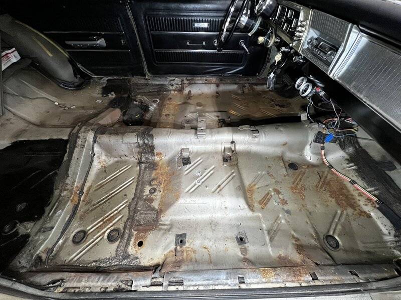

I searched the forums but didn’t seem to find what I was looking for. The interior is out of my car currently while I cut the floor for the 4spd and repair the floor in spots. I plan on keeping the original front buckets and back seat but they all need new foam and upholstery. I want to put a late model interior for a more comfortable cruiser and heard that some people are using late model Charger/Challenger/300 seats. Has anyone done this swap? If so, how was it? How much modifications needed?
What other interiors have you guys used that work?
Here’s my current situation

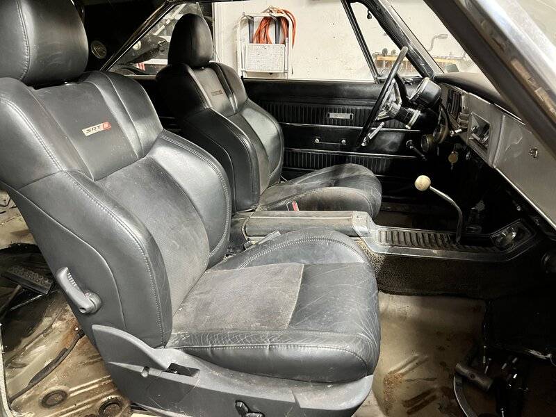

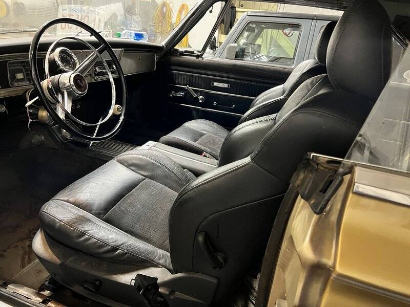

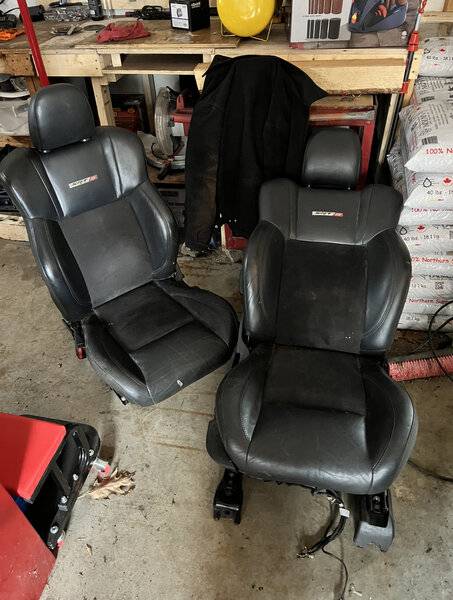

I ended up scoring a set of SRT seats out of a 06 Charger. 8 way power. Wasn’t really looking for power recline from a 4 door and preferred a two door set but couldn’t pass on the deal. Set them in place and it’s actually not going to need too much modification for the brackets
Thanks! Would be curious to see how you converted the mounting brackets.

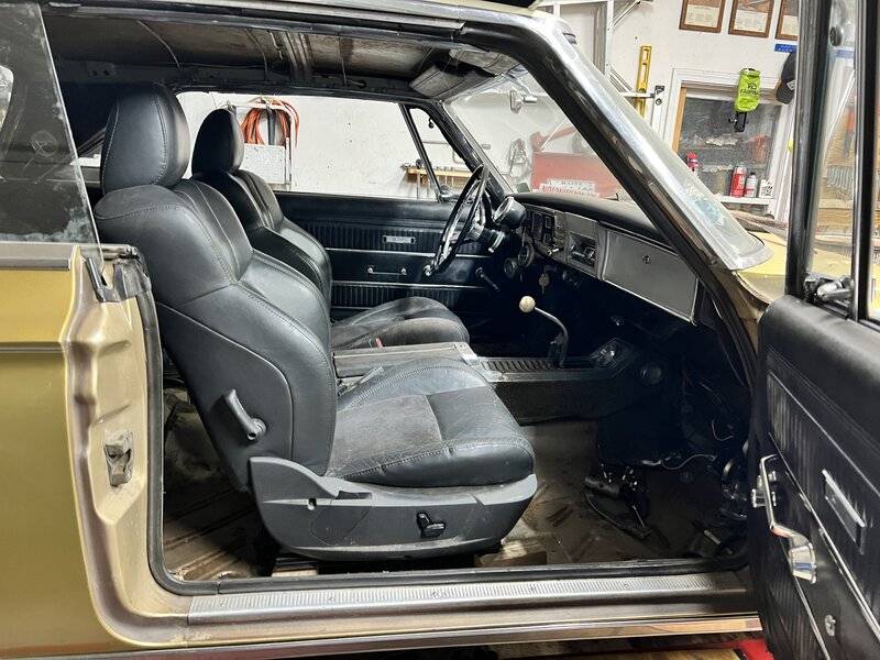

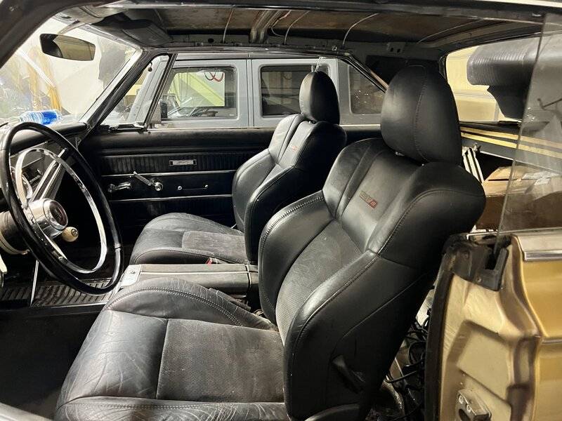

Haven't finished it yet but what im doing is, I removed the factory base and the seat will seat directly on the slider. One of the front holes in the bracket lines up with the factory hole in the floor and the other front one will sit flush and just need to drill a new hole. For the rear, I picked up some square tubing and will be making a bracket for the rear holes and drilling new holes in the floor. I then picked up some 1/4" flat stock steel which I will be welding to the floor underneath for add support to prevent the seat from tearing through in the event of an accident. ill update this with more pics and info when I complete it. Right now, Im working on patching some of the floor spots

yes pulled the factory base off the new seats. Not using the original 65 seat brackets at all. It would make the new seats sit too high. the sliders of the new seats will mount directly to the floor towards the center console and I will use the square tubing to make brackets to level the seats in the other 3 corners. If you look at the picture above from the passenger side, you can see I hav a small block of wood under the front bracket closest to the door and the same wood in the rear. I will be making adapters (brackets) with the square tubing and reinforcing the floor from underneath
