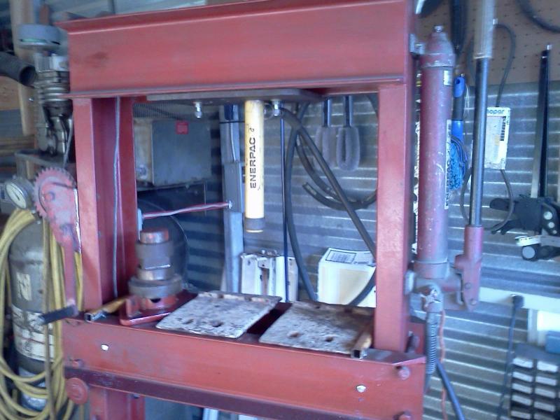

I came away with this super heavy duty press, powered by a detachable porta-power including all sorts of press plates and additional rams.
Also the HF 8" grinder/buffer, a Craftsman dial-back timing light, and an Astro no-mar lug socket set.
$180 for everything.
I'm seeing those smaller Enerpac rams for $200 and up, and I can't even find the large ram that's mounted in the press. The smaller ones are 5, 10 even 20 tons, the big one might be 50! C channel looks like it might even handle 50.
The previous owner even fabbed up a cable crank to lift the bridge. VERY cool, I like that thinking, and that's something I would have done!
They sure don't make them like that any more. It almost even looks like an Enerpack brand press!
Glad I didn't buy that HF press when they were on sale :)
Potential bad news- top of that big ram is leaking.
How much of a pain and cost is it to rebuild a ram like that?

nice score, easy to rebuild buy oily, all parts/seals etc. should be easy to get at a bearing/seal shop. great tool and good luck.
Enerpac is pretty heavy duty. We used a lot of their rams in hard to reach places when repairing railway freight cars.

Funny I was just looking at an Enerpac foot actuated pump for my press. I have a 45 year old one made in Sweeden ad it needs a new pump. They are available through Ebay pretty cheap. I might suggest you switch to a foot operated one so you have both hands free.

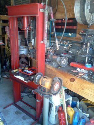

It LIVES!
The big 40 ton cylinder leaked like a sieve. I'll put rebuilding that on the back burner.
Looks like the PO got that far and ran into trouble. All sorts of things welded to it.
I went a different direction, and mounted the 5 ton 7 inch cylinder the other way.
I used what had been the table block to located the cyl under the top cross member to give a better size working window.
I made pilot holes for the 10 ton 2 inch cylinder in case I need to mount that.
I also put in a reinforcement between the mount plate (which looks to be 3/8, and slightly too thin) and the top plate (which looks to be 7/16) made from a trailer hitch #' to 2" adapter vertically wedged between the two.
That way excessive force has to A- bend the plate, B- transfer the force through the hitch tube to the top plate, and C- work against the super strong sides of the top cross member.
Since I used the press block, I needed a new one.
NOT CHEAP and hard to find.
The closes thing I could locate was an articulated commercial mower blade at Tractor Supply 1/2 thick by 8" by 10" and $51 plus tax.

One had a tie plate still attached. It's 7/16 in the middle, gradually tapering to 3/8 and then to 1/4 at outside.
There's also a rail guide that aligns it perfectly with the work bridge and puts the thickest part right in the middle.
I figured where there's one, there's more, so I took my metal detector and trowel with me to work yesterday.
Took less than 15 seconds to locate another one!
Victory is mine!
