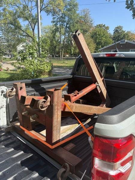

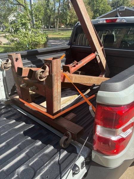

I have a small shop crane that I bought 40 years ago and has served me well. But it does not have an extendable boom so dropping in an engine over a Mopar radiator support is tough.
I found all sorts of used deals but this one was a good deal @ $75...
Needs paint but I like it.
Looks heavy duty.
I like the stowable design.
Usually don't see both those features in the same unit.

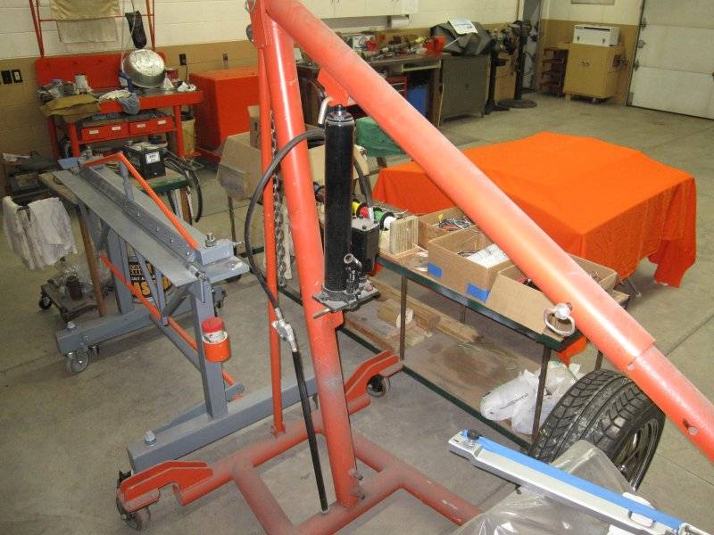

A few years ago, I bought one that was owned by a pallet company mechanic.
He repaired their fork lifts and pallet jacks.
This one has been modified with an electric/hydraulic pallet jack ram.
It's a little fast, but nice not to do all that pumping, and it has a wired remote.
Was built to run 24v on two 12v car batteries, but I modified it to use a computer UPS.
Now it's cordless and rechargeable!
The best part- it was only 50 bucks and the guy threw in a heavy duty braced engine stand.

That looks like some big tube there. What size is it?

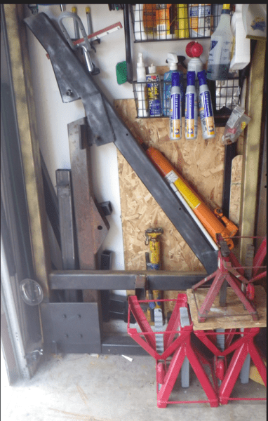

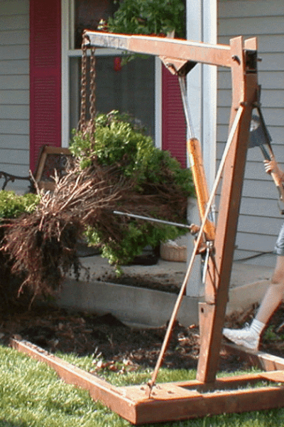

I built mine last century with 2-1/2" X 3-1/2" X 3/16" wall tube. The boom extension is 2" X 3" X 1/8" wall.
I made the base to fit my pickup bed. My plan was to dual purpose the base to use as a run stand as well but that fizzled out.
It breaks down and mostly leans against a garage wall in its old age these days.
But............. I've found it's a good place to run the end of my rattle can paints out onto. :)

Even folded up it takes a lot of bed space! Is that a Maverick?

Regarding the crane it is built from a combination of 2x3, 2 1/2 x 3 and some 4x4. It's a shop built deal and nicely done. Never had any paint on it.

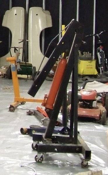

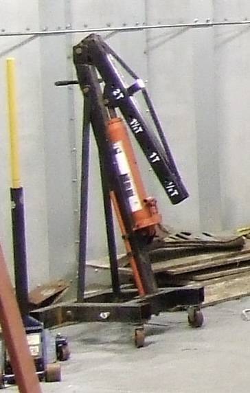

I’ve been able to lift motors over the radiator support with mine. Bought it in the late 80s. The leg extensions are on the floor behind it, and tuck upright in the square stock pockets in the base when put away.

My old one is shorter than most and has a tough time raising the engine and tran the radiator support. It was made to mount outboard motors on to boats and to raise the back end of snowmobiles for service.
I has served me well over the years. I moved dozens of engines around my shop with it when I was buying and selling early Ford flatheads and Mopar Hemis.
