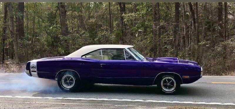

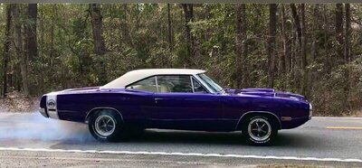

We are all back together! Car is an animal! Finally, it runs like I expect a big block 4 speed 3:73 gear musclecar to run! We will have full video's of the disc brake install, what we found in the motor, and on the road vids from Power Tour...Here's a teaser!
Just a little update before we head off to HOT ROD Power Tour 2022. We got the car back together just in time! We will have full episode of head gasket swap, disc brake install and all the fun from the tour shortly!

Sounds like a very tasty Mopar Big Block indeed!!!
Love the underhood light. I have the same one myself. Quite happy with it.
Good luck on the Power Tour!
