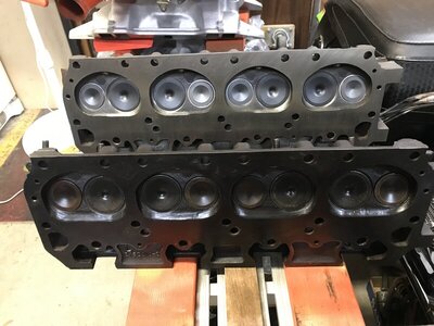

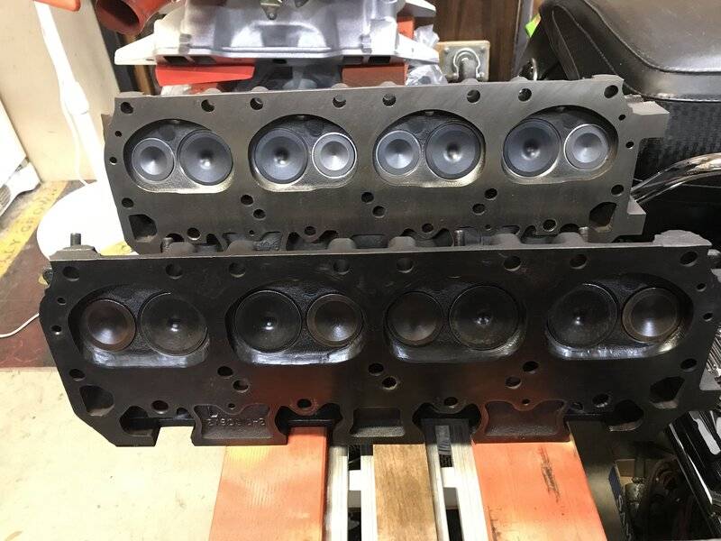

Here is a 516 Head with the hardened seats installed in the back ground and a 915 head without hardened seats in front of the 516's.

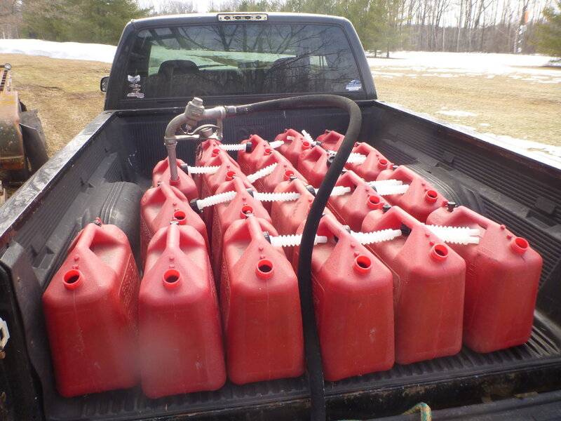

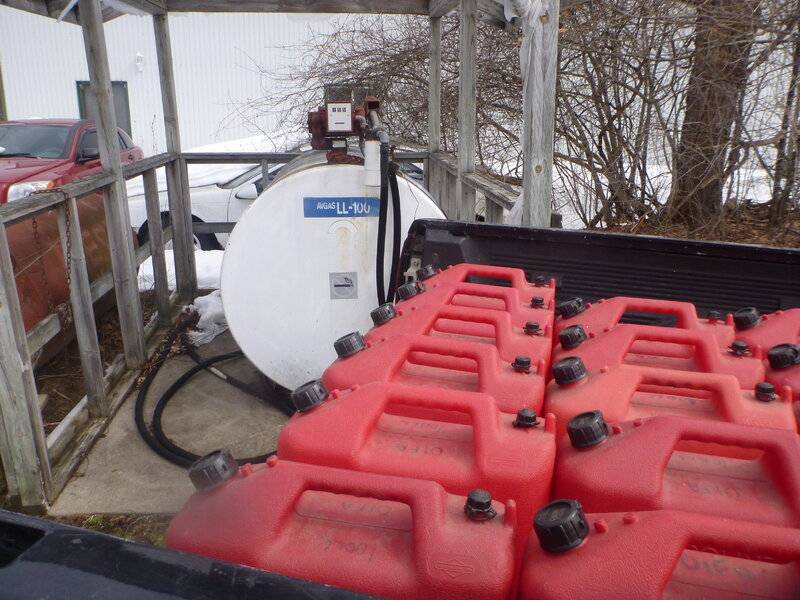

Instead of spending money on "lead replacement" snake oil, take the money and buy leaded racing fuel or 100LL aviation gasoline and blend it in with your 91 octane. A 1:5 ratio would be good. It will protect the valve seats and give a slight octane boost as well. Note that the effect of tetra-ethyl lead is somewhat cumulative so not needed every tankful for protection.
