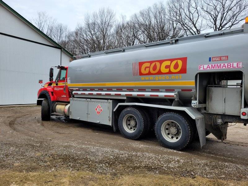

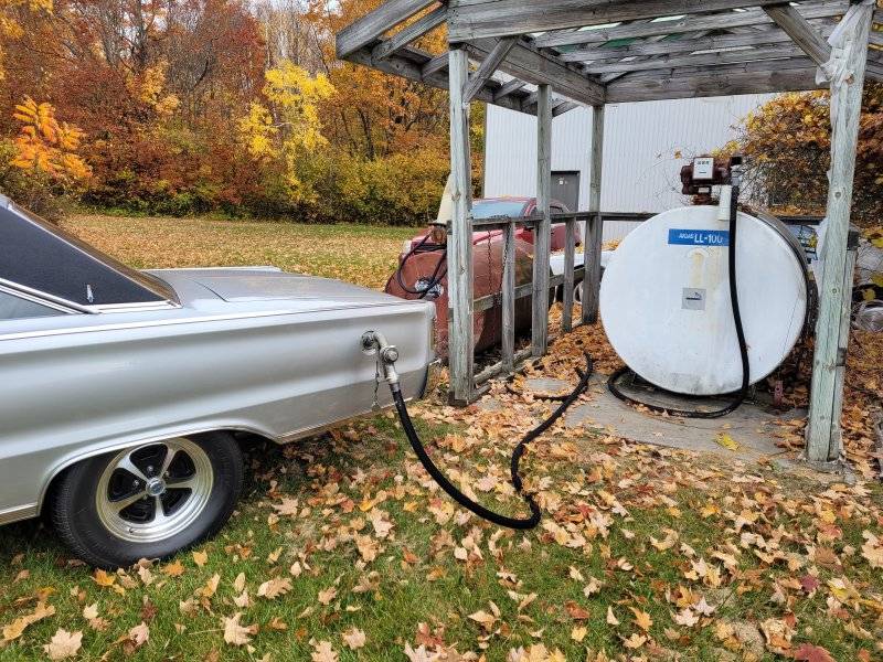

I use 100LL avgas, primarily for its octane rating, and cause I can get it, but if you're worried about the exhaust valves (considering how many miles collector cars are really driven, I wouldnt) a gallon or so of avgas is what I would do, per tankful.
