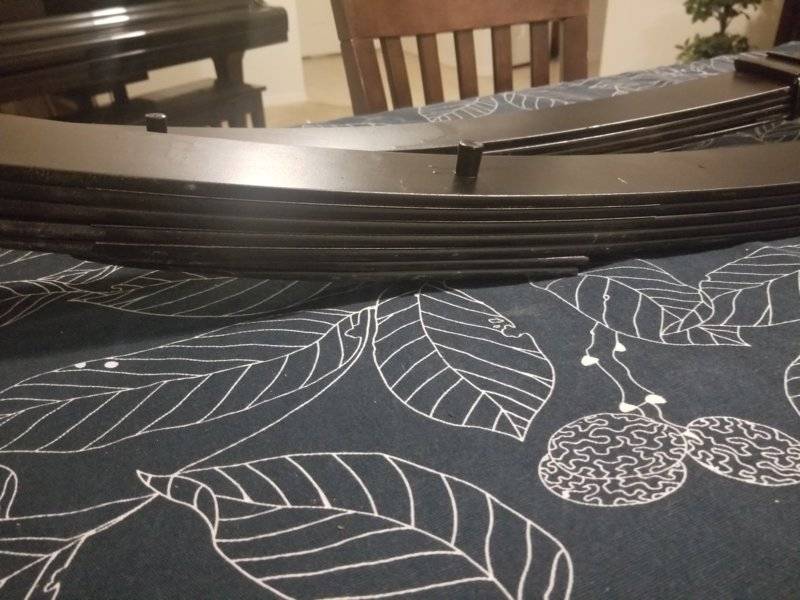

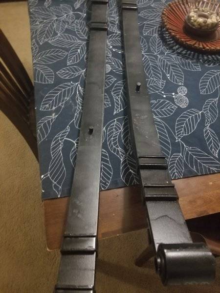

+1 for ESPO, my springs ame in this evening and they look great. Ordered all the hardware for them as well. Very reasonable and prompt on returning calls/emails.
