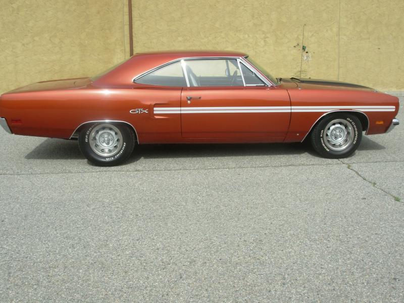

I plan to however if the bolts on replacement shackles are 3 1/2 inches apart, I stand to lose 1" of rear ride height which i'm not going to be happy with. I like the stance the car has now. DSCN3644.jpg
i like the stance too 1970GTX. btw, i have the same problem as you. prev owner put e body shackles on my 69 RR. i remember a post i did about this prob some time ago.
