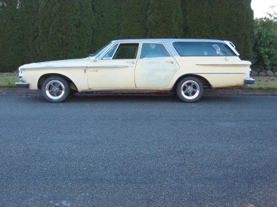

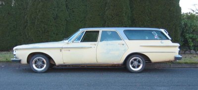

Here's how she sits with the new leaf springs and .92 dia torsion bars - much more compliant "modern" ride:
ESPO has excellent pricing.
Wheels are 15x6 with 205/60R15 (24.7" tall compared to stock 7.00x14 at 26.5" tall).
Before pic - hard to tell in pics but the after is 1.5" higher in the back, and about 3/4" lower in the front. It measures 25.5" at the center of wheels to the fender lip all the way around. Gives it a bit of a rake without being excessively street rod like....
Before - (First drive Fall of 2012):
After new .92 dia torsion bars and OE rear springs:
