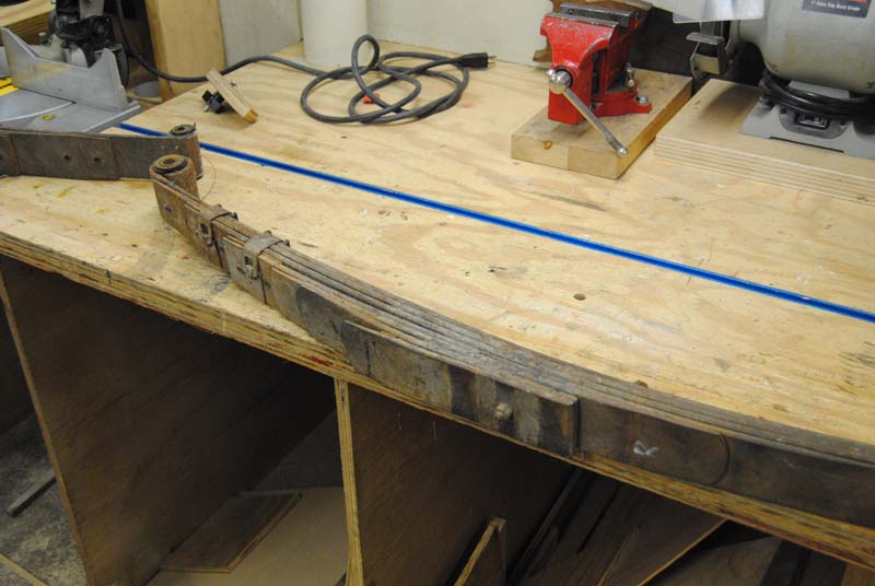

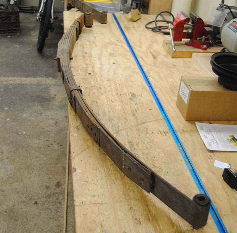

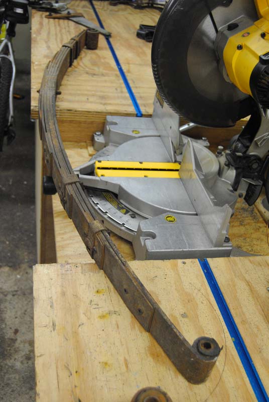

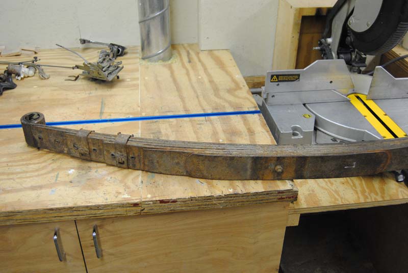

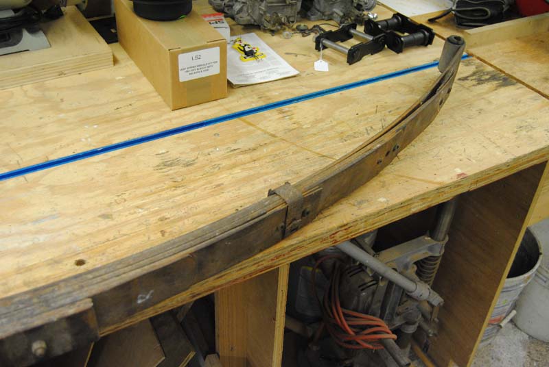

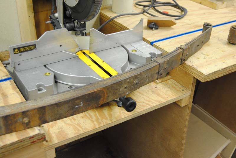

As I’m dissembling my leaf springs for my 68 Charger R/t for rebuilding, I need to ask the questions if the springs are ok. I ask this for two reasons.
1st when I flip the springs upside down (arch up) and measure from the stack bolt point on the spring to the floor below I get 7” on the left and 6 3/4” on the rights. I would guess these dimensions would be the same?

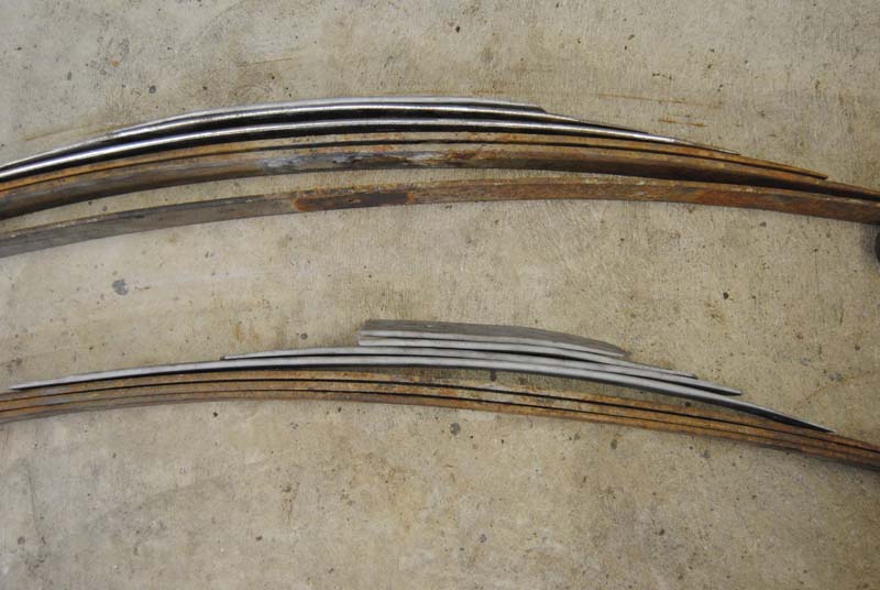

2nd as I take the springs apart the arches in the springs seem very different as to where the gaps are. This is my 1st leaf spring rebuild so I don’t know if this is normal or not. Pics below to show what I have.
Right spring:
2013 04 suspension 012.JPG2013 04 suspension 013.JPG2013 04 suspension 014.JPG
Left spring:
2013 04 suspension 015.JPG2013 04 suspension 016.JPG2013 04 suspension 017.JPG

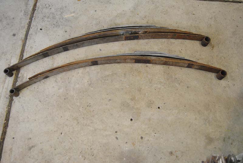

Right spring is on the bottom on the next two pics:
So are my leaf springs ok or what?

The springs are different because they have to handle loads differently. When accelerating, the car torques to the right. This is why the right spring has an extra leaf and is different. Don't worry about 1/4" difference. As long as the car is no more off than that 1/4", you're fine.
OK thanks. I understand why the springs are different / and the torque application to the right spring. However, in my mind I would think the dimension I measured on the right leaf would be the same or larger (more arch in the spring?) on the right compared to the left based on the torque on the spring. Maybe I’m over thinking this….
I would think exactly the opposite. They WERE probably the same when new. Over time, since the car does torque that way, the right spring is probably worn more than the left. It would probably not hurt to have them re-arched while you have them apart. I would not do it without having heat applied or it will not last very long.

Silly question, but did you put each one in the exact same spot on the garage floor when measuring? I know my floor is not perfectly level everywhere. I would have suggested measuring them by placing them one at at time on your work bench. It appears to be of fine craftsmanship and is probably more level than the garage floor.

Thanks for all the advice everyone! I took them into a local spring shop to have them checked out. Factory arch is 6” measured from the centerline between the two eyelets & mine were not far off. Estimate was $40 to have them re-arched and they would be done in a couple of hours. 30 minutes later I got a call the springs were “soft” = not very stiff compared to the new ones they had in stock. So I now have a nice new set of leaf springs for my ride + two sets worth the price of steel. Ah yes, another unexpected expense. :eusa_eh:
