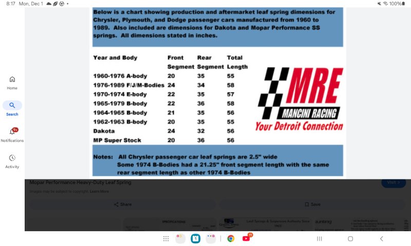

Hi guys,
could you please advise me? I'm looking for leaf springs for my 1964 Dodge Polara, with a 440cui engine. I would like some performance/street ones, I like the leaf springs from Hotchkis (HSS-24366) but in the description they state that they are for cars from 1966. Do you know if they would fit my 1964 Polara? Or do you have a tip for other leaf springs that are also good quality and good?
Thanks in advance for your advice!
