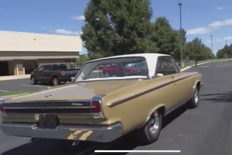

Hey guys and gals! Looking for some direction on new leaf springs for my 65 Coronet to level it up. But from what I’ve read from quite a few vendors, Eaton, Mopar Performance, Jegs, EBay, that they want a longer shackle in the front and a relocated mounting hole drilled for the rear. Some sites go as far as calling their springs, “oversized”. Has anybody swapped out old for new springs on this model without modifications?
I have more doors than most.I ordered them 1” over stock height and an extra half leaf on the right side. I also got new shackles and hardware. A friend has them on his 67,we’re both happy with them,don’t ride like a truck either. Just answer all their questions.
