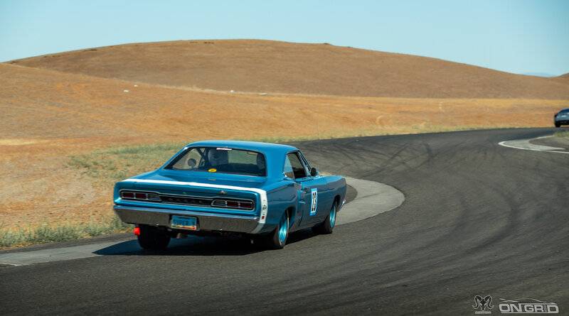

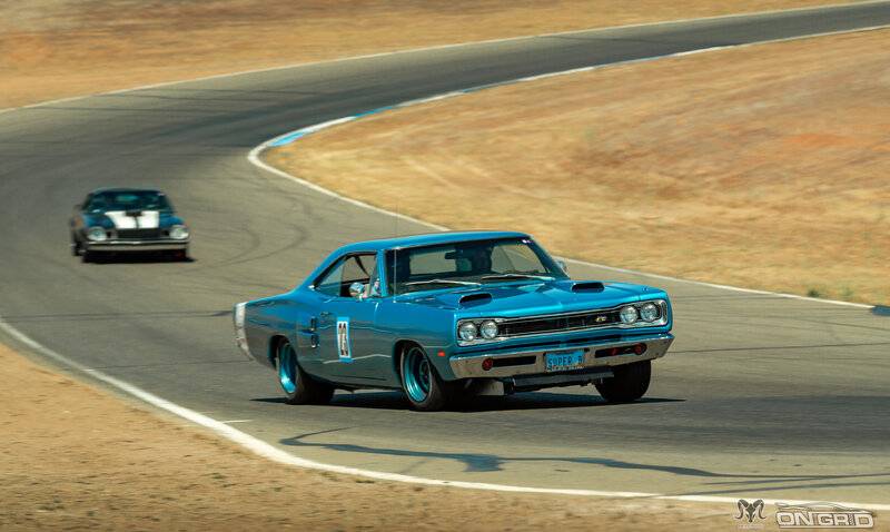

I have the Mopar Perfomance HD springs with a small lowering block in the rear of my 69' Bee. Added sways (F+R) and upgraded the front end with bigger T-Bars. It handles pretty good and is very predictable out on the track.

Here’s a link to my build. Somewhere in there is part numbers and prices….
[URL="https://www.forbbodiesonly.com/moparforum/threads/b-bodies-and-road-courses-my-super-bee-setup.220738/"]B Bodies and Road Courses - My Super Bee Setup[/URL]
I recommend keeping it simple and inexpensive, unless you are looking to compete in an actual race. My recipe for my Bee works great and is confidence inspiring. I typically go to track days with a Challenger club. I’m running a 2:30 lap time at Thunderhill, about the same as the fastest guy in a newer 5.7 R/T Challenger. The Scats and Cats are about 10-15 seconds a lap faster but they kill me in the straights. Lol. Guess I got work on my motor recipe next.
Once again, thank you for the link and information. I agree with you about the simplicity aspect after doing a lot of research and talking to a couple of people (to include you). I have a set of Hotchkiss springs here for a build I am doing for a buddy and I am going to take a hard look at them, I also have a few sets of stock B body springs so my plan is to build the car with what I have (perhaps modified) and see what I get. If it doesn't work out to my liking I can revisit it then.
Awesome car and I am very jealous that your able to track it
@Superbeemike - I just read your thread, great read and again awesome car. I appreciate you posting on this thread. When I finally get a chance to build this car I will start a build thread on it. I am looking forward to it. My Cuda is radically done with a 4 link, Viper front brakes, full bracing, etc. but i have not had a chance to track it yet.
