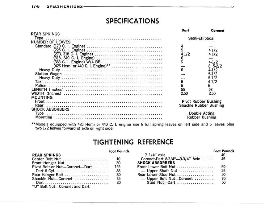

How tight do i tighten the bolts to compress the rubber bushings on the rear shackles that hold the leaf springs up
It's actually 35 foot lbs for the Coronet/Charger according to the 1968 Dodge service manual.
Only reason it sparked a memory is I just replaced the rubber shackle bushings on my '68 coronet. It also says in the manual to hand tighten the shackle nuts, drop the car to full weight on wheels, then tigten the nuts to the specified torque
