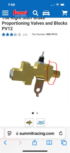

Brand new distribution block leaks from the top fitting-see pics. I removed the top fitting and replaced the “crush washer”from Napa. STILL leaks, not a lot but leaks. I called a supplier (the right stuff) asked if they had replacement washers, as the Napa was not perfect size, but said they didn’t sell separately. Anyone else have this issue? Is there a “better block”? Is there a better seal that would work?

Any pics? Brand? Isn’t your top fitting a “hex” nut with crush washer underneath it? Its where the line from MC goes…
This is the old block, new one just like it. That line went to master.

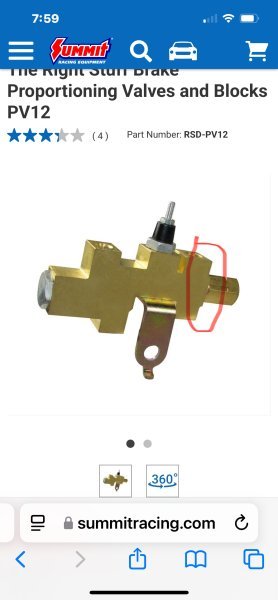

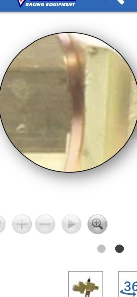

Ok, I just noticed this from the Dr.diff site and not sure what to make of it. These pics are from the same page .

I THINK your black & white pic is a block with porportioning valve, which is what i have now
Well as Gilda used to say, Oh, that’s different. Never mind. Drum all the way around no power. (Yeah, Dr. Diff is where I got it)
