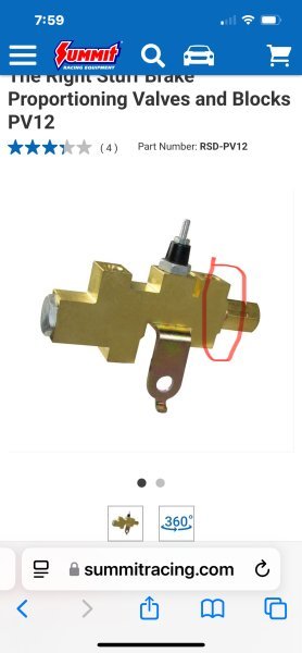

Ok, I just noticed this from the Dr.diff site and not sure what to make of it. These pics are from the same page .
Is that where you bought new one?
Is yours for power front disc, rear drum?
Thanks
I THINK your black & white pic is a block with porportioning valve, which is what i have now
Well as Gilda used to say, Oh, that’s different. Never mind. Drum all the way around no power. (Yeah, Dr. Diff is where I got it)
