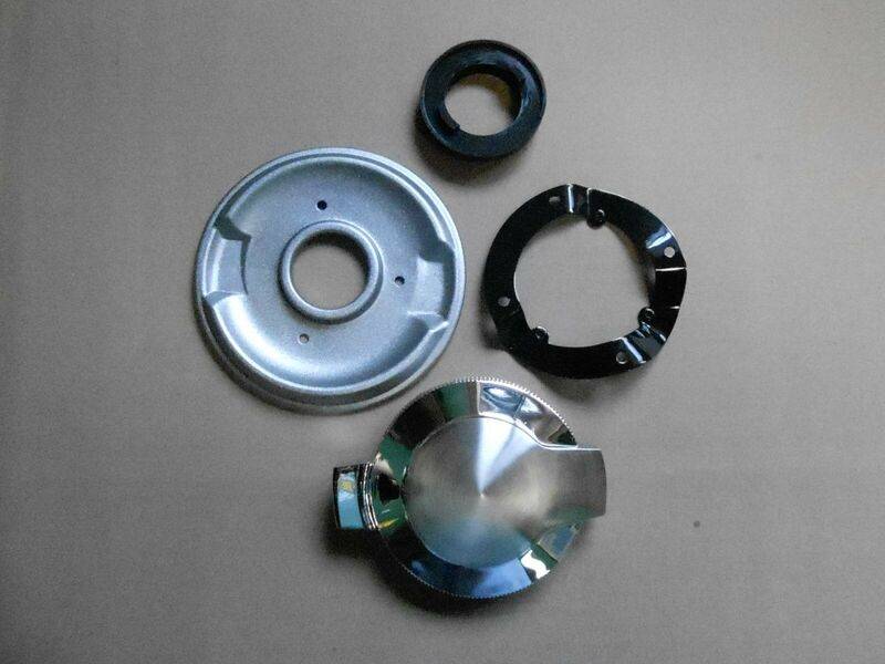

So I bought this set up for the satellite, i figured it might be an upgrade. My concern is that i may be short on Hardware to complete the install. Does anyone have a diaphragm of this by chance
