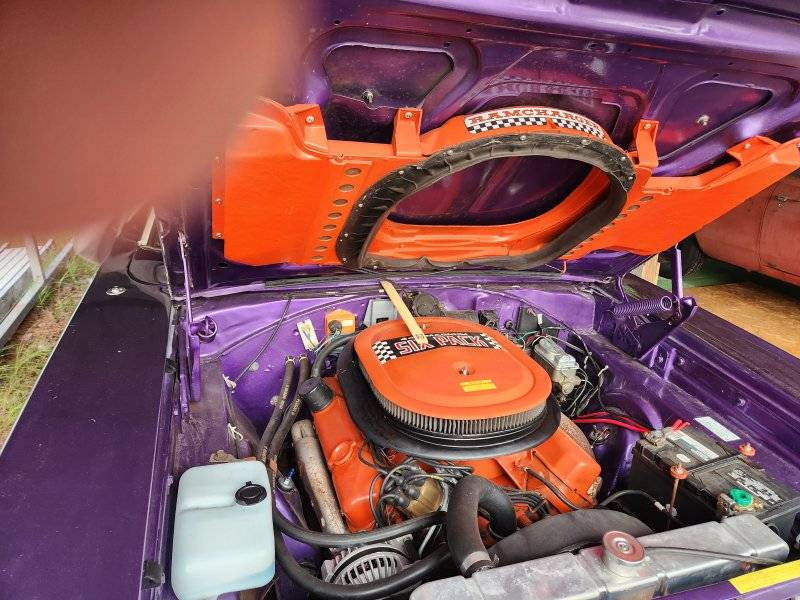

I put a Wizard 26" radiator fits perfectly in the stock location in my car, with perfectly fit stock shroud, used a short hayden clutch with a stock fan. Fits great, cools great.
