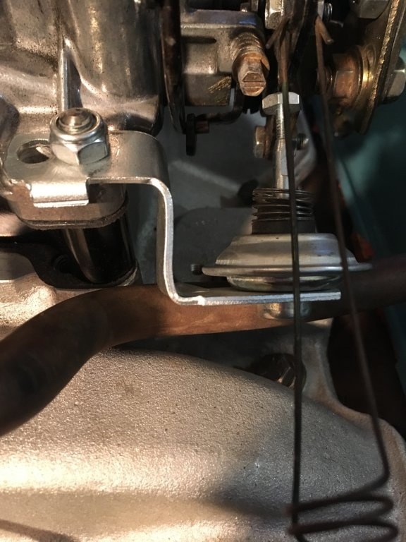

Thanks to bm02tj's hint I started looking for a dash pot.
The trick was finding one that would work for the Edelbrock. Turns out 63 64 65 Corvettes with 327s used Carters. Lucky for me, the DP-44 dashpot fits an Edelbrock perfectly.
Dashpots were quite common on OEM carbs but eventually get tossed for whatever reason, component failure, carb swap etc. We'll see how it behaves on the street...

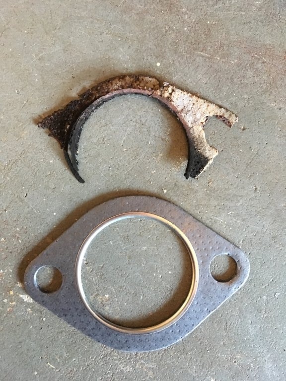

Turns out the driver side exhaust manifold gasket was disintegrated and the 2 bolts had loosened off. Replacing the gasket was on the winter TO DO list, but now with a new gasket and bolts the backfire has been eliminated. The A/F readings have also stabilized in addition to running a point lower.
Yep exh leak will cause it to pull air in on decell and it will do like an air pump does and cause any exta unburned fuel mixture to burn and that will cause a popping (backfire sound) in the exh. The air pump emissions systems dump the air to atmosphere on decell by a divertor valve so they wont backfire like that on decell. Ron
Thanks, I just learned something! Makes sense because the leak was causing the A/F gauge to show lean. In fact it was rich so I just now put the stock rods back in.

Confirmed. Up to 4000 rpm on the street @WOT all is good with stock rods and jets. I will keep the 650 for now. The exhaust leak was the cause of the backfire.
