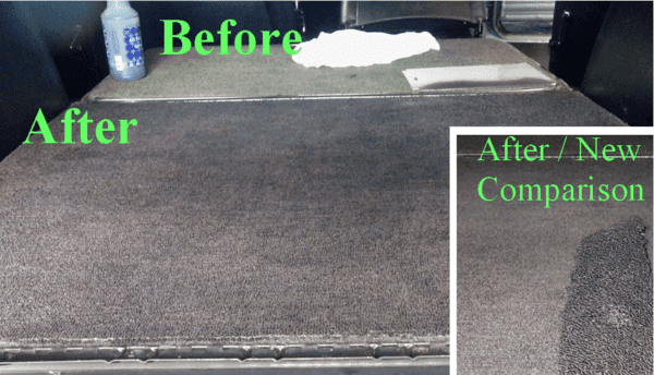

I dyed the faded carpet back of my rear fold-down and rear deck with black dye from Detail King. I didn't want to use the aerosol can stuff on it. It looks a ton better but it's not "new" carpet. I don't know what they have for leather or vinyl. You might also try Legendary for some bulk material to replace yours.
