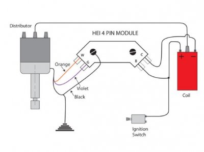

well, at least for the ignition stand point....GM modules are easy to come by, unlike most of the stock electronic components for Chrysler's electronic ignition.
I will still retain the Mopar electronic distributor, but everything else will be eliminated. Will just need to get a HEI E-core coil to eliminate the ballast resistor also

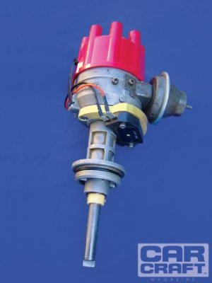

Read up on this a bit more first. I was going to go the same route. Here's how it went:
Ordered DUI distributor with built-in control module AND coil. When the thing arrived it measured a full 9-inches taller than a stock distributor!!! It quickly acquired the nickname "the Eiffel Tower". I sent it back for a full refund.
I then bought an HEI module for a '78 Vette like you show above, along with the mounting bracket from Designed to Drive. Looks simple enough. Eliminates the orange or chrome box and ballast. What I wasn't sure about was reliability. I've heard good and bad.
Then I came across Firecore. I had already ordered their spark plug set. Supposed to be top of the line and many FBBO members swear by them. Didn't know they offered GOOD quality distributors in original factory sizing. I ordered one through Mancini and I have that in my motor now, but it's still on the stand and not yet fired. Still requires ballast and control module, but has internal ball bearings and supposed to work great.
Just last week learned that if you order direct from Firecore, they offer what they call a "Ready to Run" distributor. Same exact outer dimensions as their other distributor, but with internal control module. It will take a full 12V so you are supposed to run it with one of the E-coils. Firecore offers their own mini-E coil to go with this, but I already have a new MSD Blaster SS E-coil I bought awhile ago and Firecore says that coil works great too.
I'd get the Firecore Ready 2 Run!

My thought on this is to simplify as much as possible and take off all the extra parts & pieces from the Mopar ignition and eliminate the ECU, ballast, and extra wiring....
Looking at the thread title then seeing who posted it I knew there was a catch! Anyway, HEI is a good system so can't blame you for trying it. In my case I have the Chrysler electronic already wired in so likely won't be swapping it out.

I was impressed with that firecore distributor you got so might look into one for a future build.
I've converted several vehicles to a HEI module ignition with no trouble at all. It was simple, inexpensive and very reliable ... just keep them cool. I always carried a spare module just in case though.
I'll be using the same setup on my 383.
I agree it's a good system and parts are cheap and easy.
I've got boxes of Chrysler parts and I pick them up at the JY when ever I see them (usually $25 or less for a dist, brain and harness).
Mopar pioneered electronic ignition. It's a good system as well, so I'm sticking with it.
I don't get it...what do you gain from this? I love upgrades and performance but to me this is a horizontal move...either keep an extra ballast in the dash or a GM module??? I've had more HEI modules burn out than any Chrysler ignition issues.
Either way it's your car - please don't take this the wrong way...it's just a discussion. ..;)
