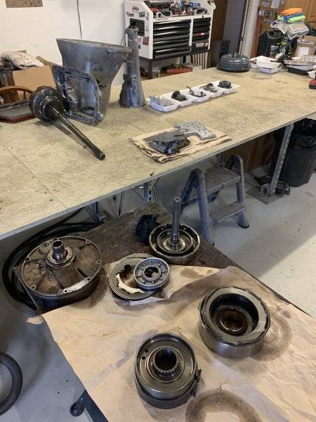

Pictures pictures want to see the carnage.
All the damage is inside the torque converter! Getting all the metal cleaned out.
Shrapnel gets stuck in the cooler too and can restrict flow back to the trans.
