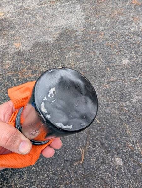

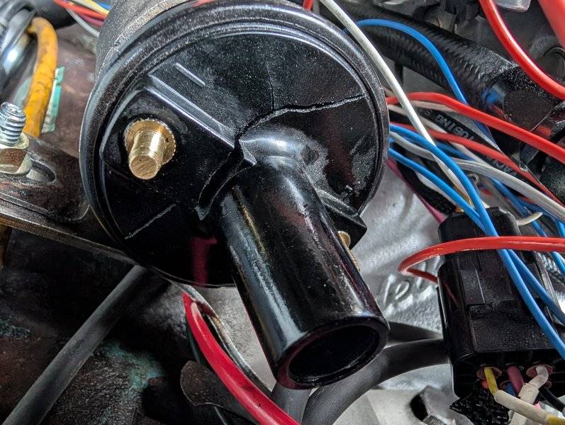

Coil has failed spectacularly. Crack across the wire end, sprayed it's oil out all over.

Never seen a failed coil look like that. My opinion is that the coil was damaged when it was installed. I am not saying you damaged it when installing. It could of been dropped somewhere along the line.

The coil did come with a dent in the base from shipping, perhaps it contributed to the failure.

The one that failed was damaged in shipping, it had a clear dent in the corner, arrived outside it's factory box inside the larger shipping box and was clearly a bit beat up. It seemed to work ok so I thought it was ok.

Some more photos of the damage to the coil (from shipping) I had seen dented coils before that worked for years so I didn't think much of it. Perhaps it was the root cause
