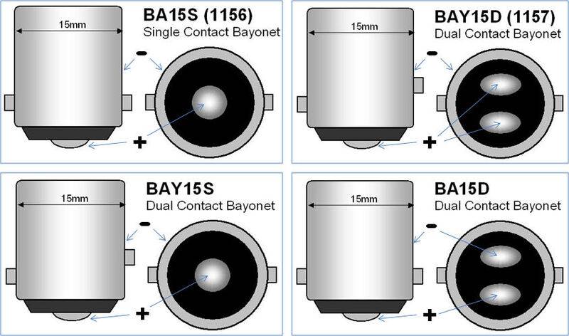

I found there are a lot of LED replacements marketed as 1004 replacements that aren’t.
The correct 1004 LED replacement will have two contacts on the bottom, power and ground connect to the two contacts and do not involve the bulb socket case.

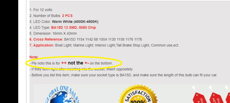

Thanks 72, Looks like we bought the same bulb. I bought these which are from the same seller. https://www.ebay.com/itm/2-X-Warm-W...e=STRK:MEBIDX:IT&_trksid=p2057872.m2749.l2649
I chose those because of the warmer color temperature. Wanted a more natural, yellow light. I have yet to climb into the back seat and put the volt meter to the light assy. I'll do that and return with findings.
Those are not the same bulbs; the description indicates the base is the negative. Technically that is not a 1004 replacement.
OH WTF ! :mad: Well, that is weird isn't it. I've never seen a bulb like that. Thank you for noticing.. I just figured the issue was on my end. I'll order up some different ones..
:thankyou:
Little update on this..... the seller shipped me out the +/- ones at no charge. (didn't even ask him to do that) Anyway, installed and all is well. Light is nice and even.

Is sellers mistake on the listing. The BA15D socket is the correct 1004 lamp configuration, but he shoud have listed it as any other
Now, wondering what the hell was he selling, because dual contact lamp with dual + leads should get asymetric pins. If he sold one like that, the lamp OP got should not fit on dome socket. Not at least without force it in
Either BAY15D or BAU15D with diagonal pins ( not on pic ) will require to force in the lamp into the socket.
I haven't found an application for BA15D lamps with dual + and grounded base.
