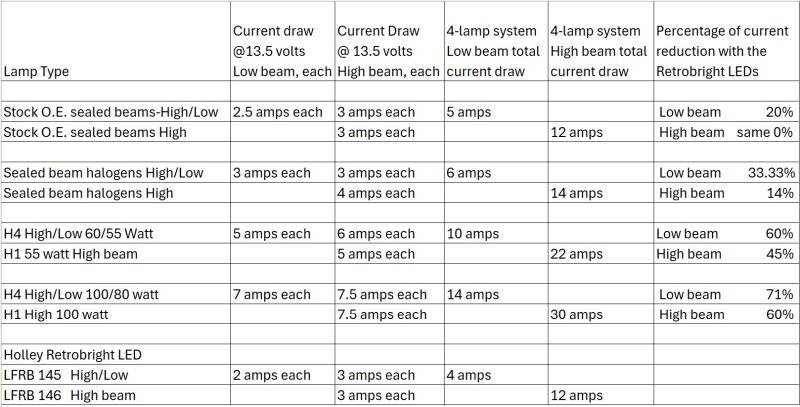

1. Unlike the OE incadescent headlights, the brightness of LED headlights is more
dependent on current rather than voltage so modifying the wiring and adding relays is not required.
The LED headlight current draw is about 25% of the OE incadescents.

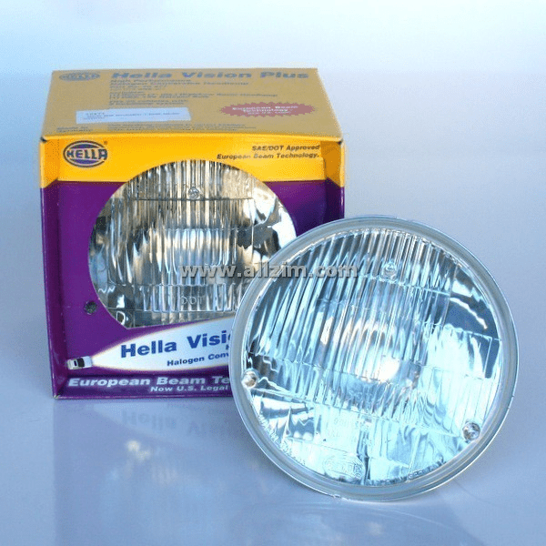

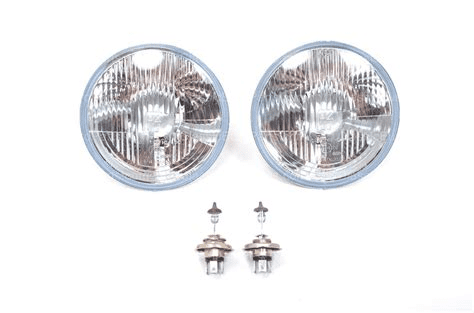

I installed Hella (NOT Holley - Hella is SIGNIFICANTLY less expensive...like, you can get them for $165 a PAIR) Vision Plus sealed beam H4 conversion lamps in my Charger (and 3 of my motorcycles...).
They make a hi/lo combo unit, as well as a high-beam-only unit for those of us with 4 lights. No modifications to the mounting bucket are required. They make them in 5.75", 7", 4x6" rectangle and 5x7 rectangle. Lenses are GLASS, and they are extremely well made, both in durability and in optics/beam spread.
All of them take a standard H4 bulb. You can use halogen; you can use HID; you can use LED - whatever you want, as long as it is H4 style/shape.
I installed H4 35w HID hi/low beams in 4300k color temp (warm white) in the outer hi/lo housings, and H4 LED high beams in 3000k (amber) in the inner hi-only housings - LEDs for instant-on switching when I need high beams. The HID kit I got came with its own relay and harness (they draw about the same as an incandescent when they're warming up, but once they've warmed up - figure 10-15 seconds - they have minimal current draw); the LED's don't require one. I used the factory socket for one high beam as the trigger for the whole setup, to trigger the relay for the lows and turn on the highs. No cutting harnesses, completely reversible if a future owner "has to have concours-correct".

Retros are not 25% of OE draw. They draw maybe 25% less (certain conditions), according to tested results from 72RRGTX who is independent of the manufacturer sale brochure stuff.
They draw roughly the same as an OE 4 headlight system and only marginally less than a sealed beam halogen set up. Get closer to 14 volts to the lights, amp load is reduced.
