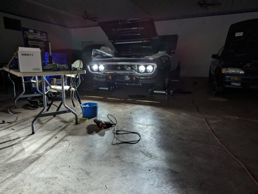

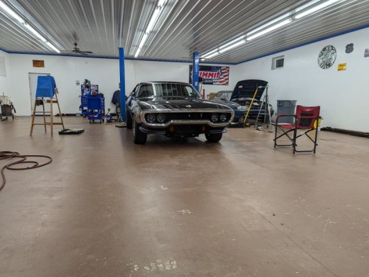

I used the black ones below in my 72. They are great lights and DOT legal. These are a different looking light so all depends what you are looking for in the looks department. I attached a picture of what they look like when they are on and off. I rewired the entire car so low and high are all 4 lights but they would connect into the OEM wiring. You do have to modify the headlight buckets to make them fit.
