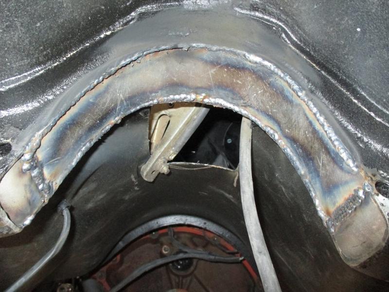

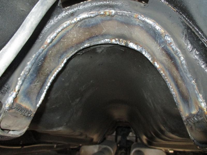

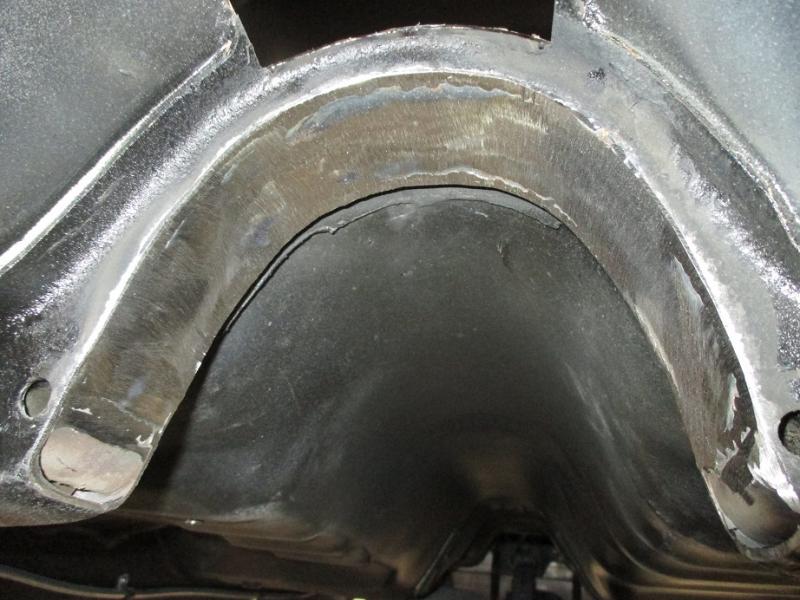

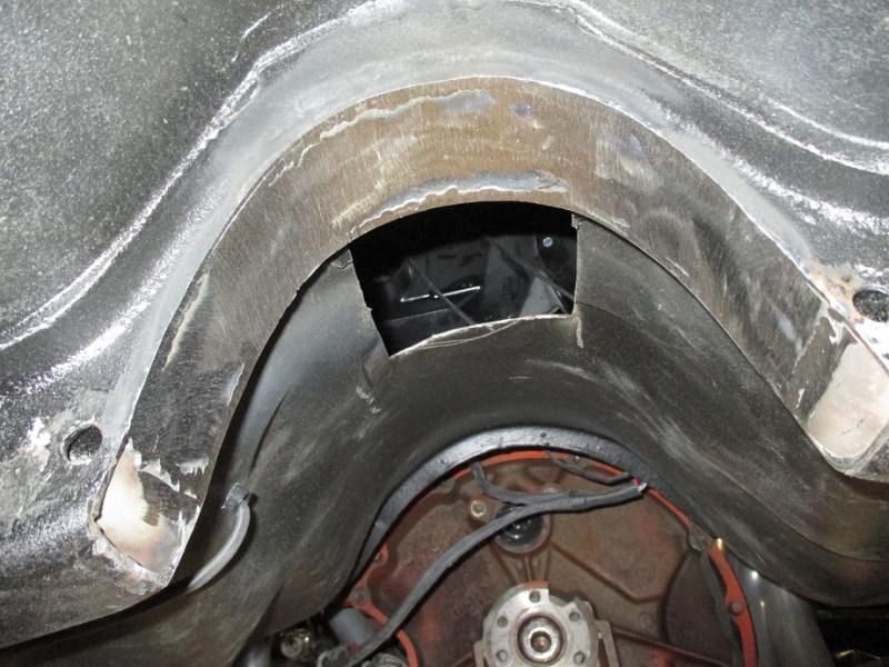

More photos coming ran into a slight problem but nothing I can't fix. Had to machine a new pilot bushing had a weird bore size in the crank.
finishing up the trans tunnel modification just boxed in the crossmember a few little tweaks and its good to go. IMG_0020(1).jpgIMG_0021(1).jpgIMG_0022.jpgIMG_0023.jpg
used 12 gauge steel. Had a question for you though. did you use the stock return spring on your clutch pedals?
