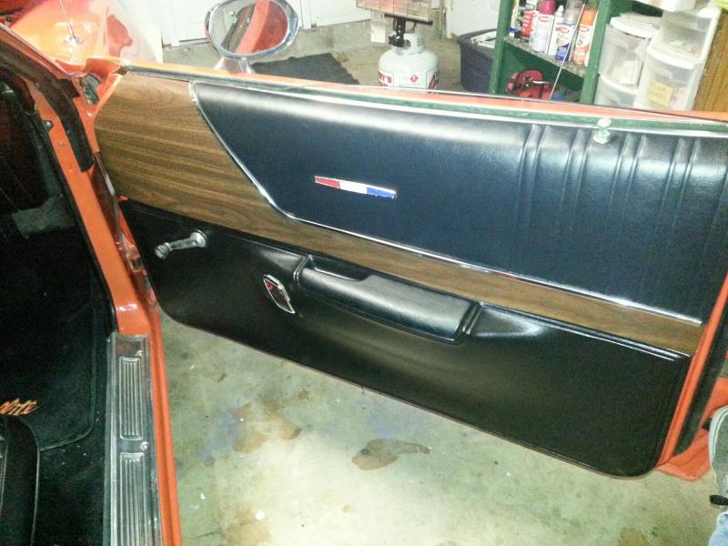

I just did the same thing. I ordered them and recieved the material and carboard only. I took to upholserty shop and had them remove the old ones and install the new. They turned out great. I had to cut out the side mirror hole on the drivers side panel and the door lock holes. Save the little old door lock chrome bezels off your old panels...you will need them!
I also installed the 2 Satellite emblem's on mine. Its a 72 SSP.

Here's a picture of the upper door panel.
Looks great! Now I'm really getting excited. The only thing really wrong with mine was the chrome, it was peeling like a banana on the front panels. The rears were fine. Take care
