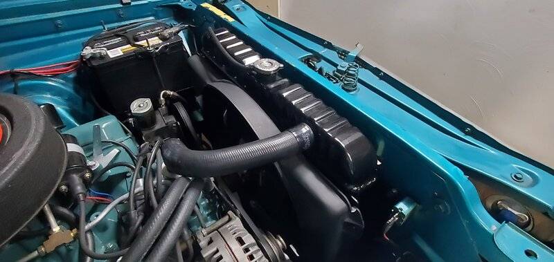

Got a link? I got one off ebay which sounds similar to what you're looking it except in 26"....I'm very happy with it...fitment was perfect and stick shroud bolted right up too...
My car was factory 22" radiator, I opened it up on the pass side to fit the 26"

That's who I got mine from, but in black...they are thicker and i had to change the fan clutch to the shortest one hayden has... it's a small amount of cutting to make that opening match the factory 26" hole...for me having the bigger radiator was worth it. And unless you're really looking for it nobody will know it was done.

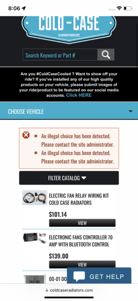

well I’ve gone and done it now! looks like I
made an illegal selection:lol: on cold cases website.

The Cold Case in my Charger along with the 528 Hemi and A/c work perfect. It did not fit the bottom slots. They were just off a little bit. I also can not say it was 100 percent the radiator as my core support was 22 inch and I put in the 26 inch panel and I could of been off the little that I had to trim on the radiator. I also have the Cold Case dual fan and shroud. Car does not overheat and that was my concern.
A few years ago, after I impaled a perfectly good FACTORY radiator, I replaced it with a garbage Champion, then a Wizard which I've been pleasantly surprised with the fit (exact) and the performance with a clutch and shroud.
