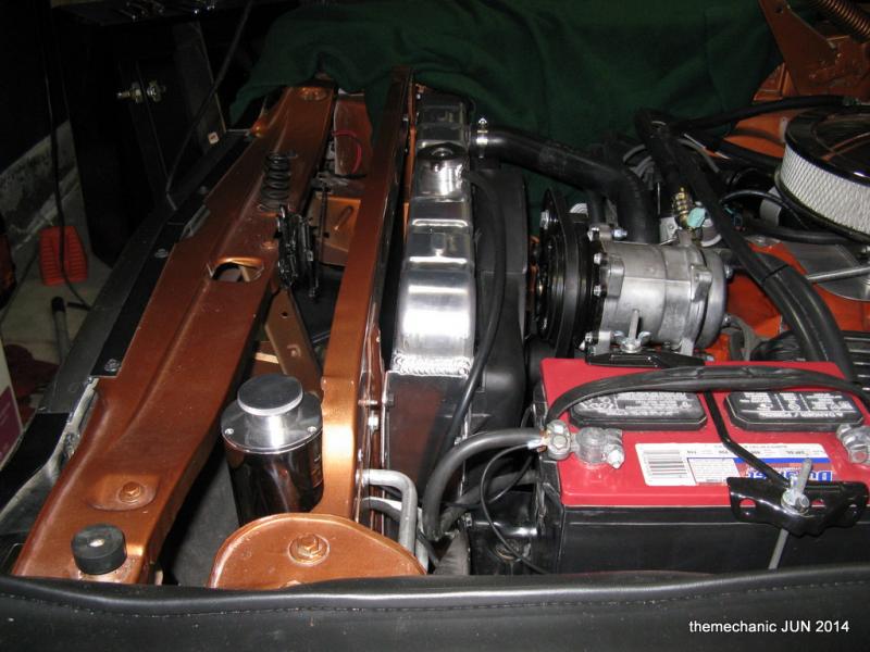

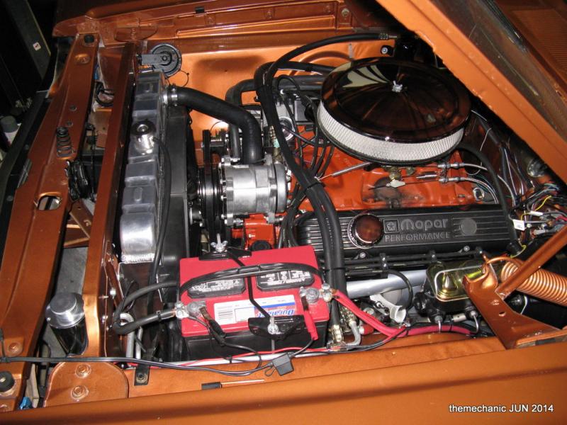

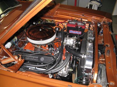

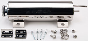

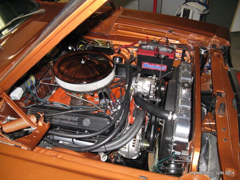

I bought the Jegs stainless steel recirculating tank from Amazon.
http://www.amazon.com/gp/product/B007VRALP4/ref=oh_details_o00_s00_i00?ie=UTF8&psc=1
As you can see, there was no room to mount it on the engine side due to the AC lines running thru the radiator support.
PLEASE NOTE: (1) You have to find a location where you can get a pop rivet into the brackets which means where you can fit a drill to drill the rivet holes. (2) You have to make sure your hood will close when the bottle is mounted (don't ask how I know).

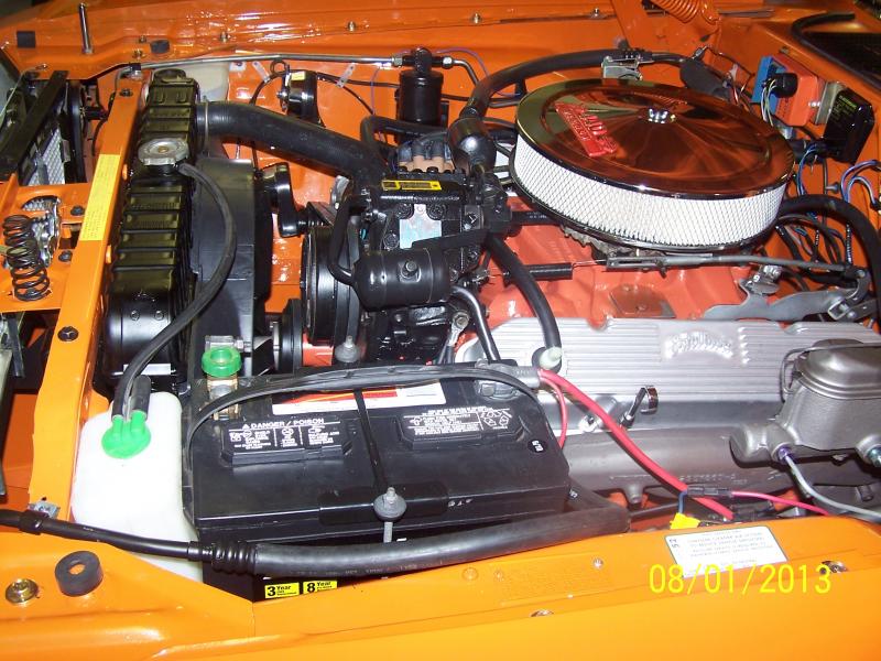

I use the cheap square universal over flow tank at most stores.... it fits between the battery and core support with no modifications other than bending it's mounting tab to grab the support.

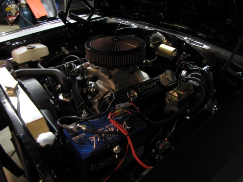

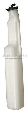

100_5674.jpgI don't usually allow any Generic Motors parts on my Mopar but I did give in a little on my Niece's Challenger. I used a bottle taken from a Junk yard Geo Metro (don't know the year).
It fit perfectly between the core support and battery and doesn't look too out of place. It is not bolted in but I just dropped it in and wedged the battery against it and tightend the battery strap down. Here is a pic.

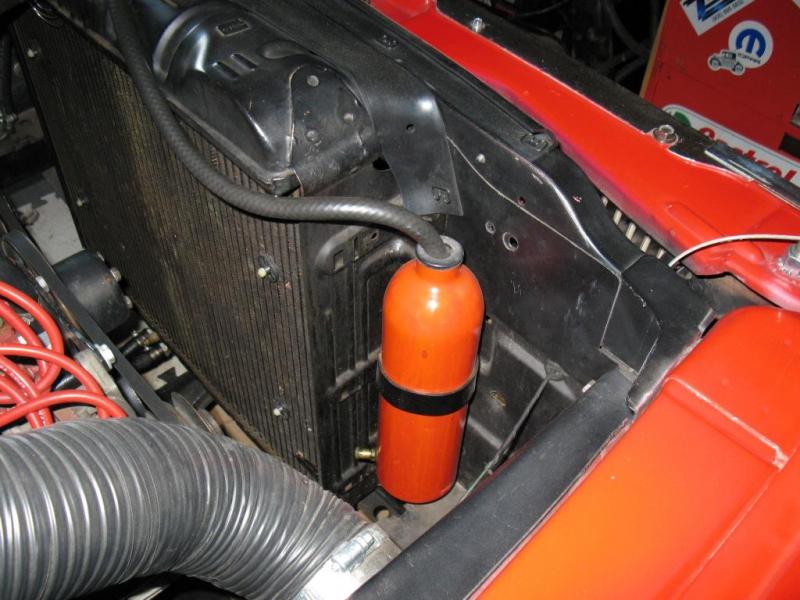

I use an old fire extinguisher with a drain cock drilled on the bottom.

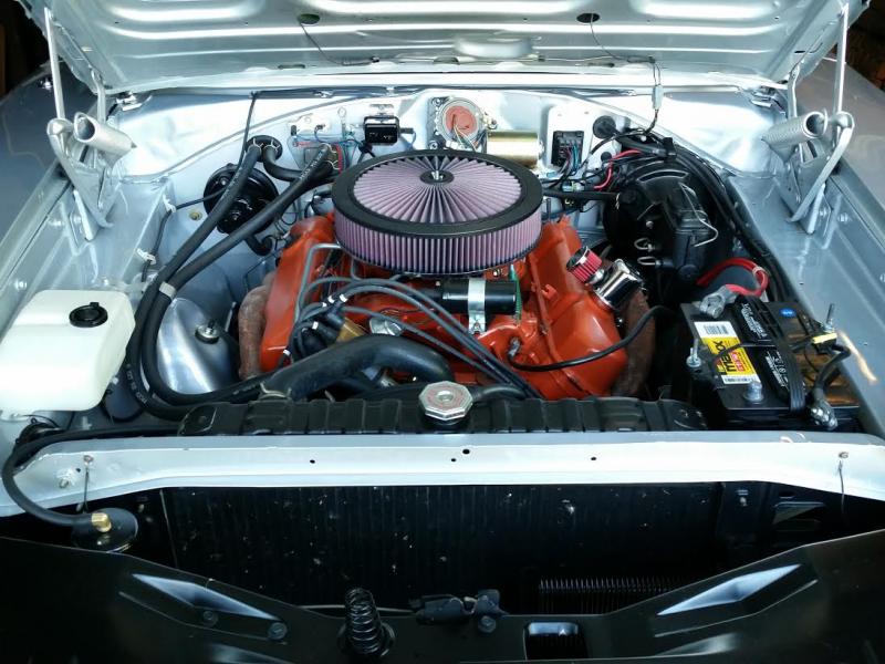

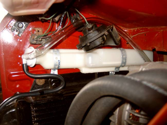

Found this shortly after I redid my 67 Charger in 04. Purchased new for around $10.00. Mitsubishi overflow fits nicely in there. Part # MR188696

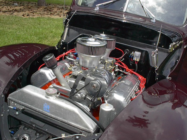

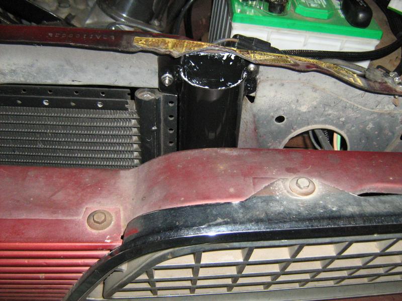

This is an aluminum can I bought from Jeg's for my 40 ford, it allows coolant to be recovered. Vent is at the top overflow hose attaches to the bottom.
