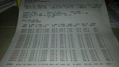

Hi, running a crane hyd.roller (HR-230/352-2S-12) with Crane 1.6 roller rockers and Crane roller lifters.pushrods were custom fit. My 440/ 493 is street driven with about 6,000 miles on her.
Motor is 9-7.1 with Eddy RPM heads and intake with 850 cfm Demon carb, TTI 440-200 headers.2,800 stall Pro torques converter.727 has all the good stuff, bolt in sprag, 4 pinion planitarys, large clutch pack shift kit, deep pan.... Running drag radials with 3:23's outback.dynoed at 536Hp, @ 5,200, 588TQ @ 4,000 on 93 pump gas.with a very wide torque band. This cam makes plenty of vacuum zero issues can drive this thing any where.

View attachment 433934 View attachment 433935 View attachment 433936
That's a nice street build for sure. Gobs of torque all over the place.
