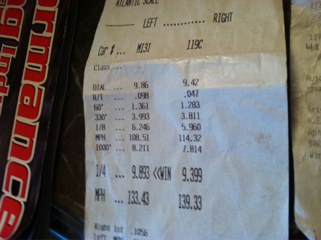

Here's my time slip for the 65 Plymouth. 60 foot very good. This is by no means my fastest an Mph is down. Dead hooking on this pass. I remember it well. Just for a comparison. I'm 119C BTW.
MPH looks slower than expected for those numbers.
