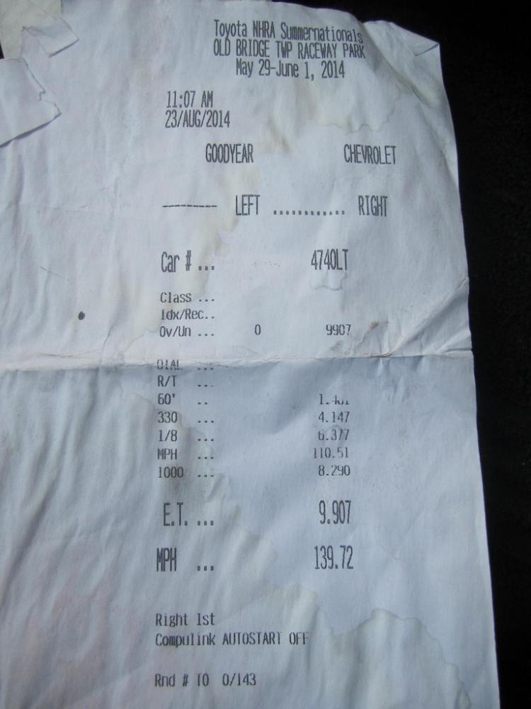

That's more like it!
Any chance you have a time slip of it?
I don't have that run, but here's the first run that night. We had too much nitrous in down low and spun on the 60'. These are all 275 drag radial runs. Not slicks.

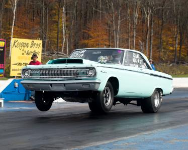

I'm trying to find a solid .15 and wondering if it's in my 1/8th mile or in the last 1/8th mile of the run.
One of my cars like the black dodge is lazy the line but then comes on like gang busters right at the 1/8th mile.I figured what was wrong now with this car. It was in my Prosystems SV1's which I have now corrected and just waiting to get out to test.
The light blue dodge is excellant off the hit and 60 foots insane but comes up a bit short in the 1/8th and my MPH is off some since the rebuild. Only thing I did differently was raise the ladder bar up 1 hole to get it to hit the tire harder but I think that's where my 1/8th mile ET is off.
I might be over reacting but I miss my 5.73 1/8th mile in the light blue dodge now it's 5.76-5.77
