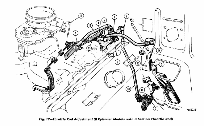

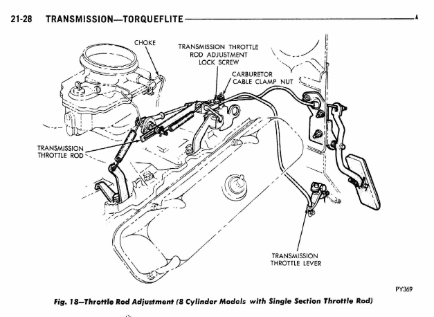

Hope this helps, it's from the 1970 FSM.

You have an adjustment at the rear of the engine in the rod that goes down. That adjustment will give you more throw forward and backwards on the pump lever on the transmission. The trick is to get the proper throw to shove the transmission lever all the way back at WOT. Watch the first video above. Its is very helpful to show how it should be set up. I mean these setups have worked for years as they were engineered to. With proper setup they will last for years to come.

The correct way is to make sure the back side of the slot is resting on the throttle pin. Then go under the car and make sure that the pump pressure adjuster is all the way forward. Then Go to WOT on the carb and check the lever on the trans. If it is not all the way back for max pressure then I would suggest adjusting the rod that goes down behind the block. That rod will give you more front to rear throw on the pump pressure lever. In the second video they go over several styles of kick down linkages. The tool they use to set this up pulls the pump lever all the way forward. This is how you set the rod with the slot in it.
