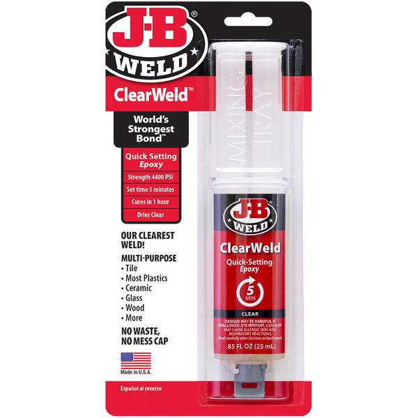

Another idea if you have a good lens except for being cracked is to use this.
I did it with good results.

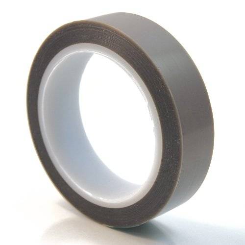

I used Teflon tape of keep it where it needed to be till it set up.
Won't stick to the tape.
This PTFE tape with silicone adhesive is handy stuff to have on the shelf anyway.
We used it on airplanes to pull wire into existing harnesses.
Slick stuff with no adhesive residue.
