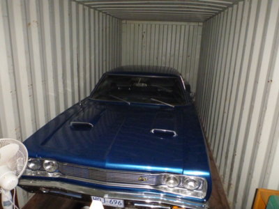

I have a Brand X car ( 60 Vette ) that I let sit for 6-8 months at a time before I use it. I usually put some Stabil in it. Usually cranks right up....
14 years, started on 2nd crank! First crank was to verify oil pressure!

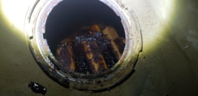

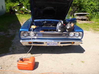

Today’s gas is your worst enemy. It doesnt last long and plays hell on the fuel system.
