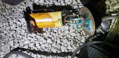

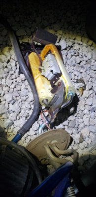

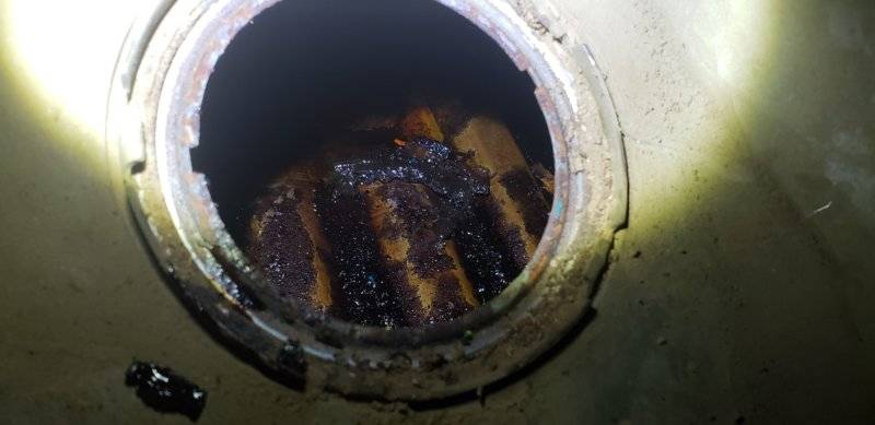

Definitely use Stabil or something like it. modern ethanol laced gas SUCKS.
This is 10 year old gas damage. 1994 F150 that was parked with 1/2 tank. The 8 gallons of fuel that came out was the color of mud and permanently cloudy. The sock filter is completely shellacked shut and glued to the bottom of the tank even though it was 1/2 full. Tank and sender are ruined and the injectors aren't happy but coming back with fresh fuel and some heat in the engine.

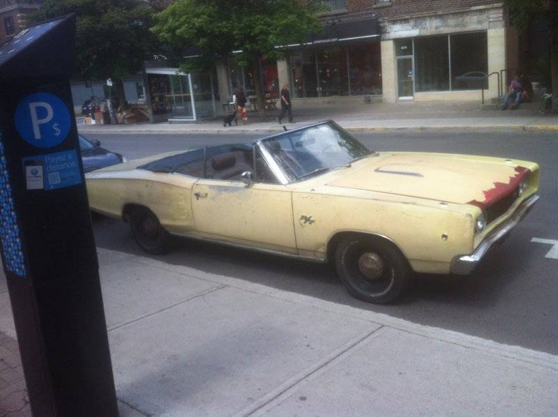

I'm sure a lot of you remember when our cars were
new back in the 60s &70s they sat on dealer lots
outside in heat&cold .
That could be for weeks&yes for months. Granted
we had different gas back then,but pretty much
everything else was the same.
So that being said the things posted above are all
Good ideas,hell I do most all of it,but don't freck
out to much,they are survivors.
