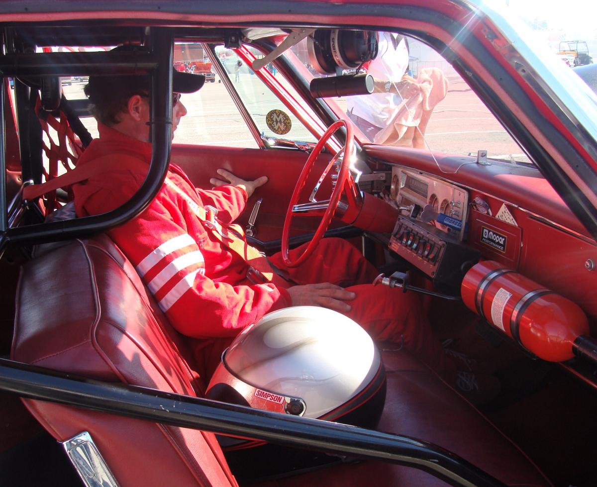

We have had great success with the lexan in the 64 Dodge. The glass was too heavy and eating ET and MPH. You just need to make sure you have an experienced installer. I believe the installer we used heated the lexan before installing. The seals around the lexan are original from glass. The only problem we had was the lexan wanted to bend in the front around 1/8 mile. The Dodge runs 150 MPH, so if you are running that MPH you may want to add a 1/4 reinforce bracket on the dash to insure it doesn't bend or bow. I have attached a pic so you can see the bracket. As far as the cleaning, just make sure you use the right cleaning product and a soft rag. We have not had a single scratch and it stays clean and shiny as the day it was installed. Hope this helps!

Not to get too off topic but tell us about your pushbutton extension. More shots of your car in action wouldn't hurt either.
btw glad to hear your lexan windshield treats you right.
It is just extended on the back of the shifter with aluminum bracket. With the seat belt couldn't reach the buttons! Just improvised! I have some other videos posted. Here's another one. http://www.youtube.com/watch?v=l0MBYhPMtj4
