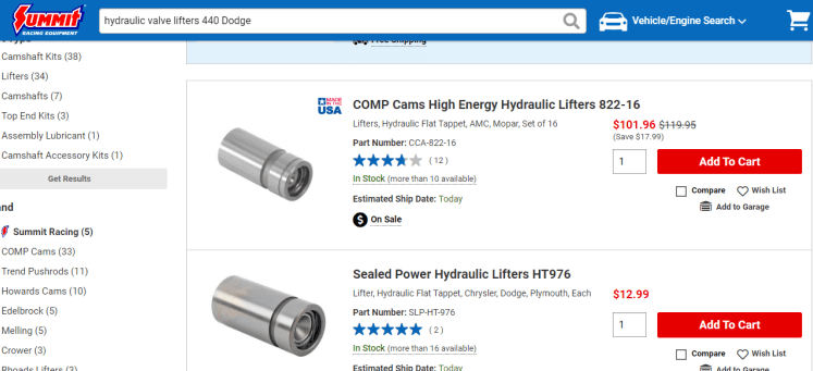

Yes...Hydraulic flat tappet lifters for $200 or less a set or $1000 for decent roller lifters.
