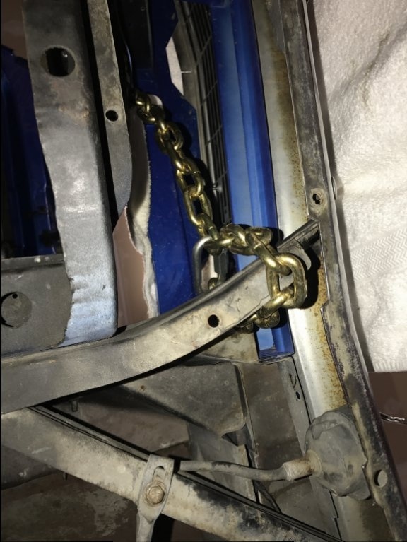

I lifted my Demon by running straps in through the engine bay and under the frame rails to the bumper mount bolts outside. I had straps that fit the bolts nicely though. It was surprisingly light.

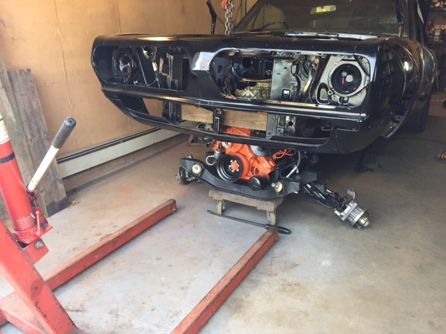

I've found it easiest to use a length of 4x4, cut to fit between the rails but catch on the flanges on each front rail. You can see it in this picture. Used it on A and E bodies. Works great.

Good idea. I ended up using the bumper mounts. Between the bumper and the radiator support. Worked fine. No issues.
