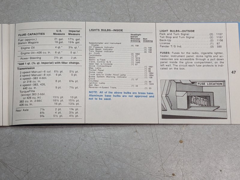

The original illumination, turn signal indicator, and oil light bulbs in the 1969 Satellite are number 158, of which there are eight. If equipped with a tachometer, it uses a number 57 bulb.
The bulbs are listed in the owner's manual as shown in the following image:
Page image taken from:
Vaanth,
Cool, Thanks a Lot!
