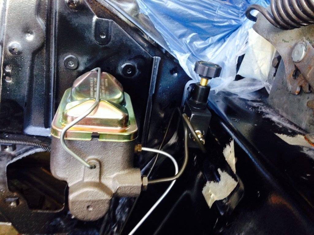

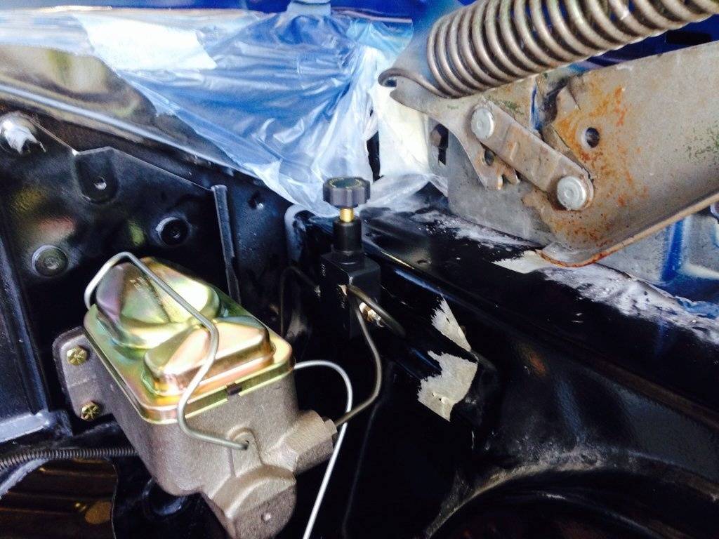

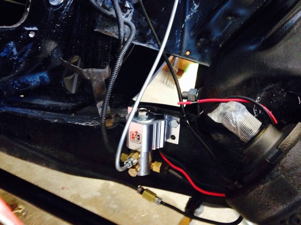

Hey guys, I'm doing a front disk brake conversion on my 69 net. I figured it was a good time to add a line lock also. Can I just eliminate the stock original distribution block and run a proportioning valve to the rears and T the front brakes together and run them into the roll control unit. Effectively eliminating the need for a stock distribution valve.
you can use the line lock as a tee cause they usually have extra ports, so less plumbing.
Line lock and prop valve installed (minus wiring).

I don't know. Hurst has a diagram for different types of master cylinders (single vs dual), many different ways to configure.
