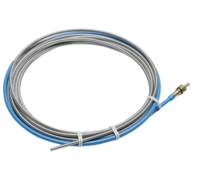

Usually the liner has a brass end on it. The liner slides in from the welder end and you clip off the excess at the gun end. The end with the fitting is part of the conductor but also forms the gas seal. the bare end is the gun end.

If you Google "Tweco liner" they all show that brass end I was referring to. And they all go in from the machine end.

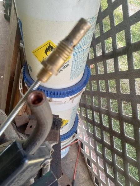

Proof that the liner comes out of end of the gun.....just got it out today but I had to murder the machine end to get it to free up.
Hey @gkent ......did you not see this or chose to not see it?? You're wrong :D

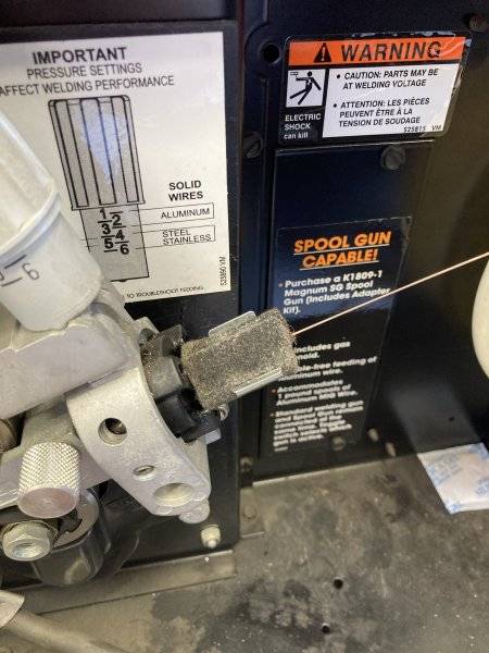

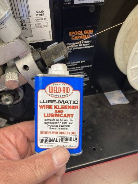

Something for the MIG users out there. I've used this for many years. A felt piece with a band around it that you soak with this fluid. You can get it at your welding supplier.
