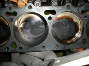

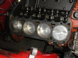

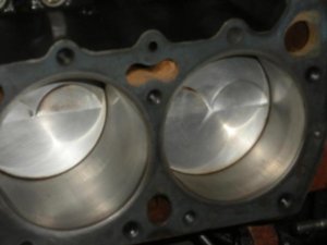

It was a strange thing. Common sense would have told me that the compression ratio was not to blame. I tried different distributors, ECUs, different timing settings, springs in the distributor and even 100, 104 and 110 octane fuel. Only the 110 completely eliminated the knock. I pulled the heads and found zero evidence of detonation. I was told and I read that detonation leaves sharp impressions in the pistons as if they were poked repeatedly by an ice pick. All my pistons looked fine. no marks but just discoloration from some oil burning due to a poor fitting intake manifold.
Finally, lowering the compression was the fix. I could have pulled the engine and swapped in dished pistons but instead, I had the heads off to be ported and used a .075 head gasket to drop the CR to 10.07 to 1. No problems since.
My pistons before cleaning and after.
No marks at all. I know I heard detonation but there was no evidence of it.

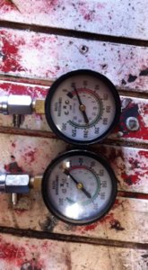

I had a reading average of 210-215....THEN I realized this:
The gauge that I was using started at 30 psi !
This was like the man that wore two watches....he was never quite sure of the time.
With the other gauge, I was in the 188 range. The switch to 1.6 rocker arms closed up the spread between the cylinders but did not lower the numbers much, if at all. A switch to a more radical cam made it worse because even with a rougher idle, it apparently had an earlier intake closing point. This was a real learning experience and although it was a real pisser at the time, I do appreciate the lessons that it taught me. I had threads here, on FABO, Moparts, DC.com.....I was reaching for help in all directions.

Always thought that a gauge that started a 30 psi just wouldn't read under that? Am I misinterpreting what your saying?
Looks to me like the gauge starts at 0 but the needle is resting at 30 so it'll most likely be reading 30 psi high....
That is exactly what was happening. It made me think the numbers were WAY too high.
