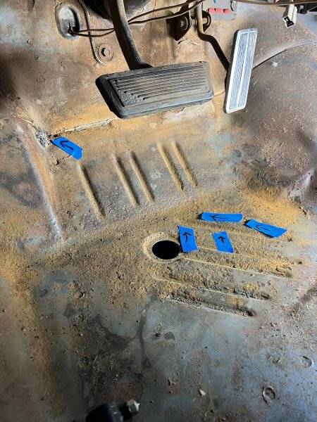

Can these pinholes and small holes be repaired in the floorboard or would it be better to repair them or go with more costly upfront of removing the floorboard and replacing them?
If repairs, what?
JB Weld?
Something else?
Thanks!

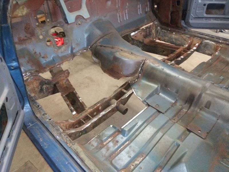

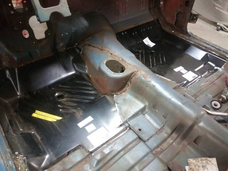

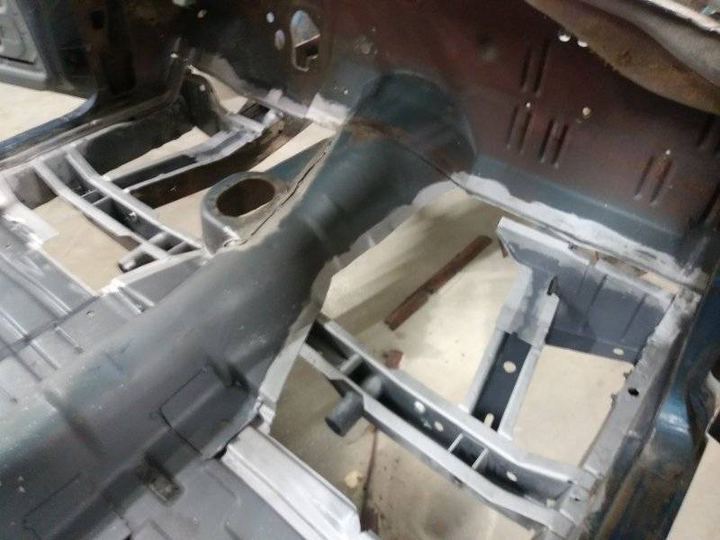

If that area is your only weak spot, there is no way I would replace the whole pan. Clean everything up good to see what you are dealing with. The top arrow is a seam, so probably ok, only needing new seam sealer. Here is what I have done in the past. For that small area, just buy a cheap Sherman patch panel and use what you need.

I think if you were to sand blast that area on both sides you’ll find more pin holes. If you have good metal around pin holes you can throw some mig weld in there. You’ll probably just keep blowing out the metal if it’s thin. I’ve used 3M panel bond in small pin hole areas before, back it up with tape and it’ll flow in to the holes. Rock solid when done and it sticks. You need to start by cleaning that up with sand blast or wire wheel. Nothing will stick to it the way it is.
If it cleans up without a lot of holes and it is still stiff, it'll be fine. Get it clean and then decide. Welding thin metal pin holes is a pain. I've successfully patched them with All Metal, JB, even seam sealer on pin holes. Do both sides. If it's clean and water tight it works. I'm talking cars that have been painted 35+ years now.

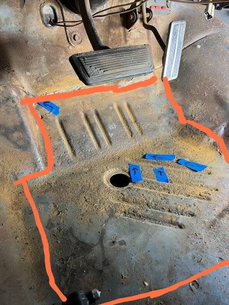

Excuse the fat finger but this area needs to be removed and then replaced with a cut down aftermarket pan.
Need to get outside to good steel.
I would clean up the whole area just to see how the rest is as well. And replacing with a pan is a good idea. Do you have some skills to replace? It is awkward in that area.?

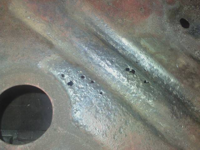

Trust me I've welded plenty of sheet metal. And no place better to learn than on floor pans. That being said I've made better looking small hole and pitted metal repair than many of the repacement pieces I've seen welded in. So it depends on the desired result and your skill level.

If it were mine I'd blast it to see just how bad it is and lean more towards repairing the floor you have. I keep copper laying around just for this, huge help when it comes to closing up pin holes.

I'd clean n weld the pin holes...I'd weld from the inside with a piece of copper plate or pipe backing up floor from the outside...That is exactly what I am going to do on my 70 Coronet

Better off filling those with All metal, Epoxy, seam sealer. You end up with a glob of weld 20 times the size of the hole.
