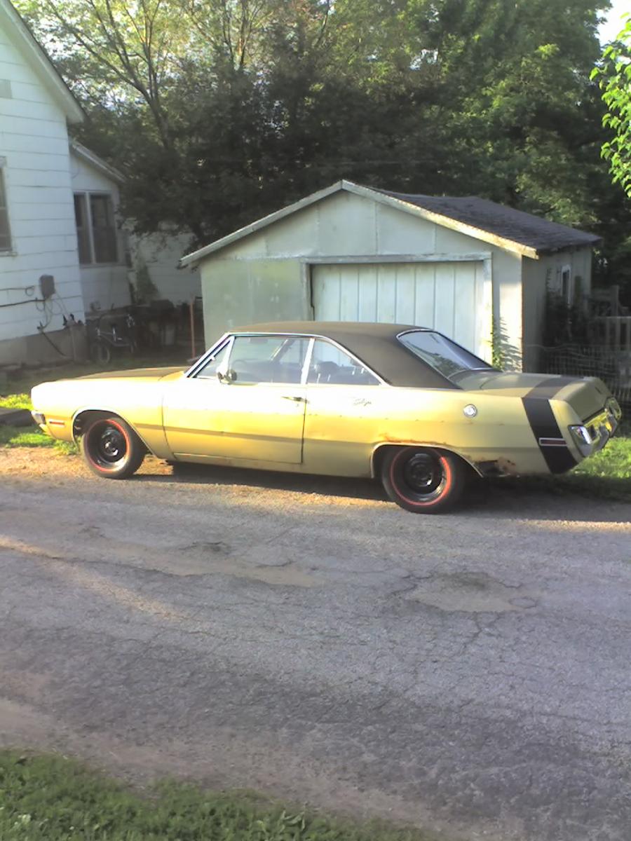

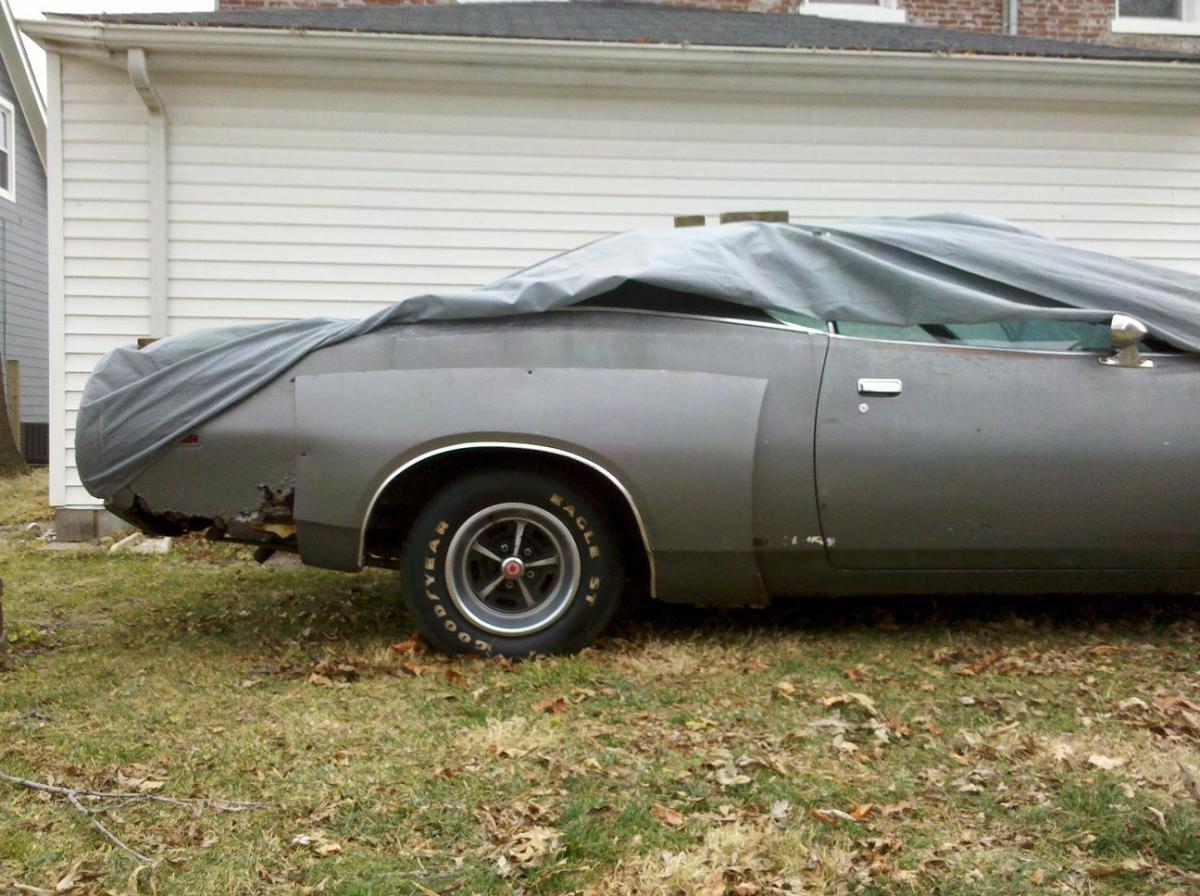

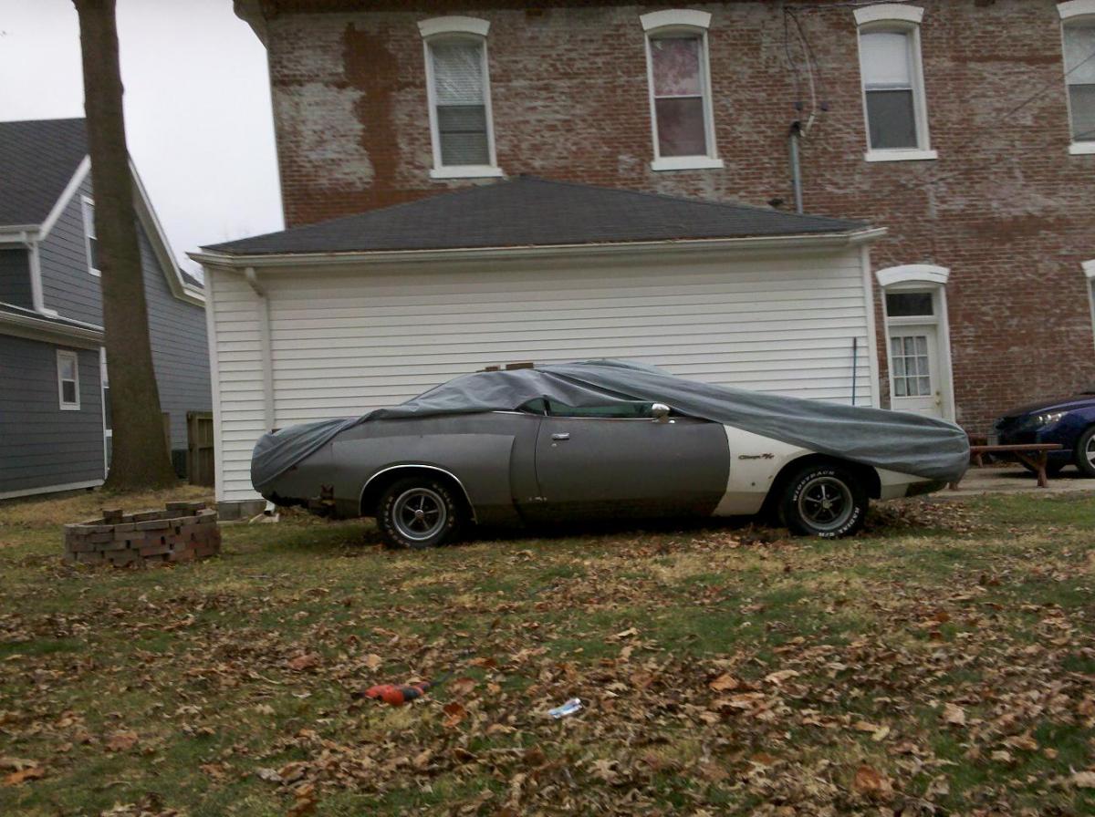

Looks that way doesn't it lol...is complete and pretty nice but has some serious quarter rust on the ps. Drivers side isn't as bad but I think when it comes down to it the car will get two new quarters.

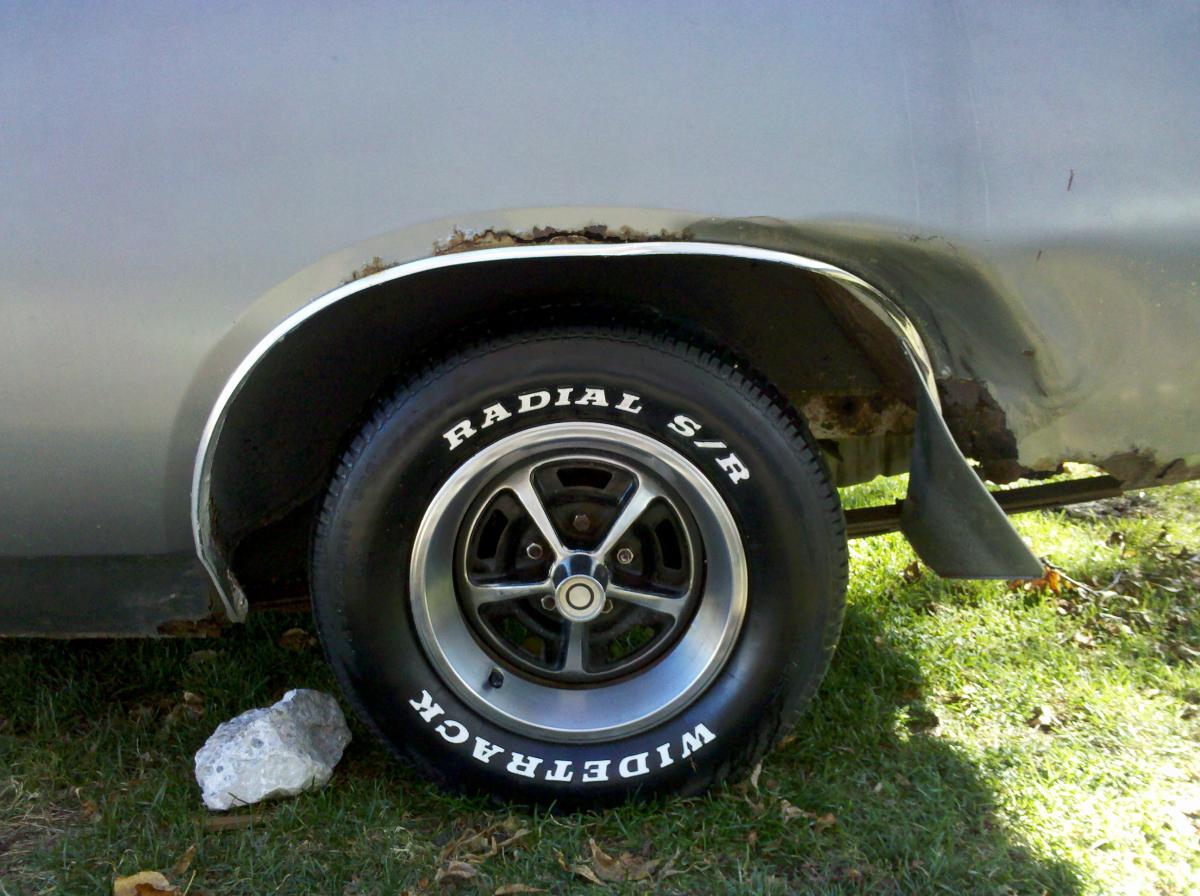

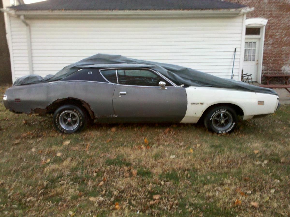

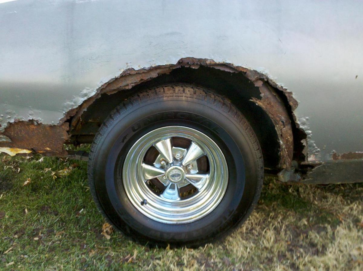

Okay guys, need some help here. Car is literally falling apart in areas now that I am prodding on them. 1/4s shot! To include outer wheel houses and trunk extensions, rockers are shot (look solid from sides but bottoms are gone), fenders shot; ps dogleg had putty in it and is now rotted up approx 10 inches, ds fender has some rust in dogleg but worst is up front above headlights...IS GONE (was bubbled but when poked fell apart completely and now is 4x3 hole). torsion bar subframe ENDS are shot, just the ends, rest seem nice but where they meet rockers are toast. Doors have holes starting in corners, hood is solid I guess, trunk lid lip has rust but is salvageable. Crazy thing is floors and trunk pan look great. Oh yeah have found some crunchy spots under vinyl roof along front windshield area that I am sure are all the way through. Rust seems to have eaten car from inside out...under fenders is so crusty, all metal lines; brake and fuel are shot agghhhh
SAVE or Part? There is really no sentimental value with car, son located it but we have a project already that he bought and are working on. So, with all of rust damage to me it seems like a money pit that will get worse once bad metal comes off (no telling what is under it hiding). I am now rethinking saving this one...and either finding a solid body that needs what is nice on mine (interior, glass, bumpers, front and rear valences, etc) and using her for parts or just parting out and concentrate on other cars...decisions decisions.

Besides terrible ps 1/4 and wheelhouse rest I can easily replace. I needed to just take a step back and let it all settle in and realized I've fixed worse. Pulled complete interior out and floors and trunk are gorgeous. Rear frame rails are solid as well as cowl area up front and inner fender/rails.

Anyone ever done this? I have some wicked rust on my passengers side quarter and after some quick measurements thought maybe just maybe I could use my front wheel opening from my clapped out fender as a patch. Noticed opposite front sides almost match opposite rear openings by mocking up wheel opening trim. Well today cut out my fenders opening and quickly fit it up against the back...mind you its off center a tad but look at the body lines and is not perfect but really close to original rears. I think with some trimming it'll work fairly well and on the cheap.

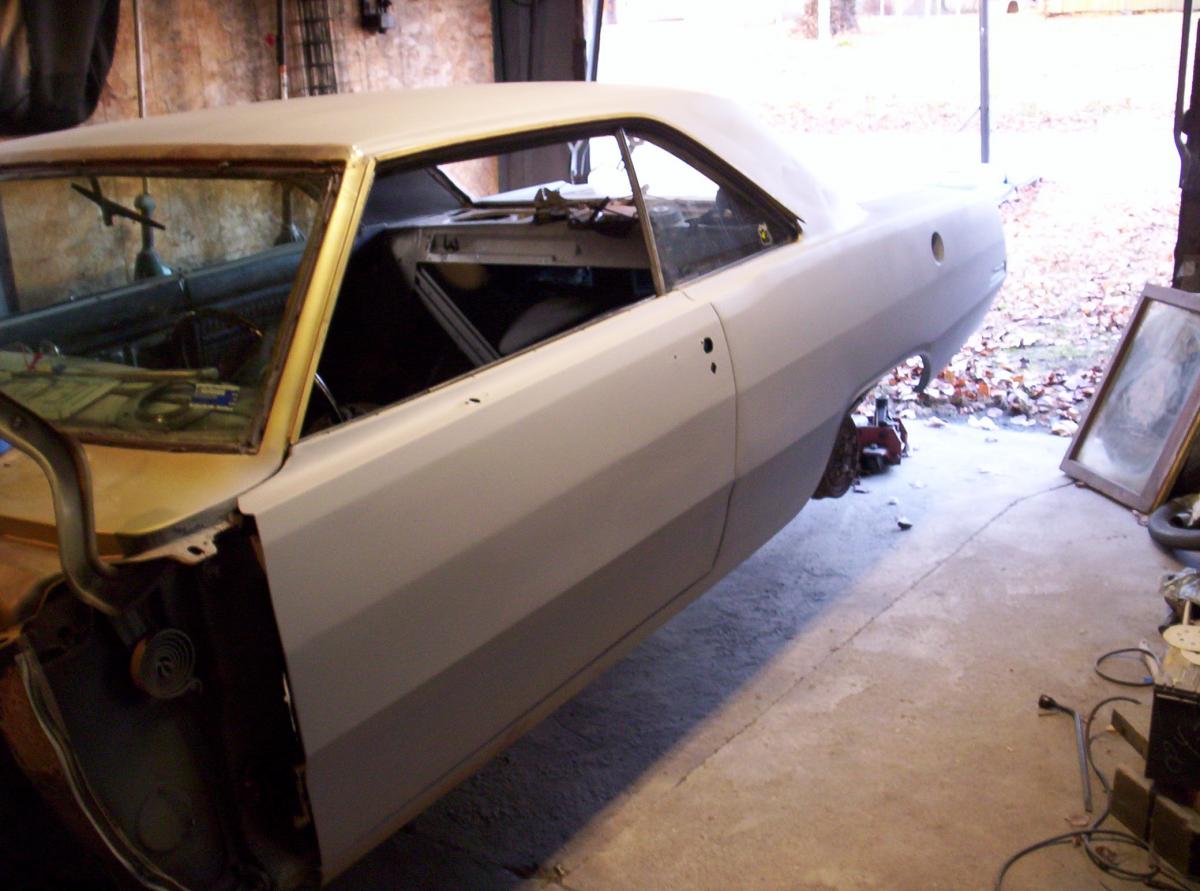

Good looking a-body there! It's not as bad as I thought, bad but saveable. I've bought most of the sheetmetal needed now for it just waiting for spring to jump on it. Way I figure for what I bought car for and with new sheetmetal and my labor I'll still be in it cheap and be able to enjoy it and let people see another one on the road versus in a scrap yard.

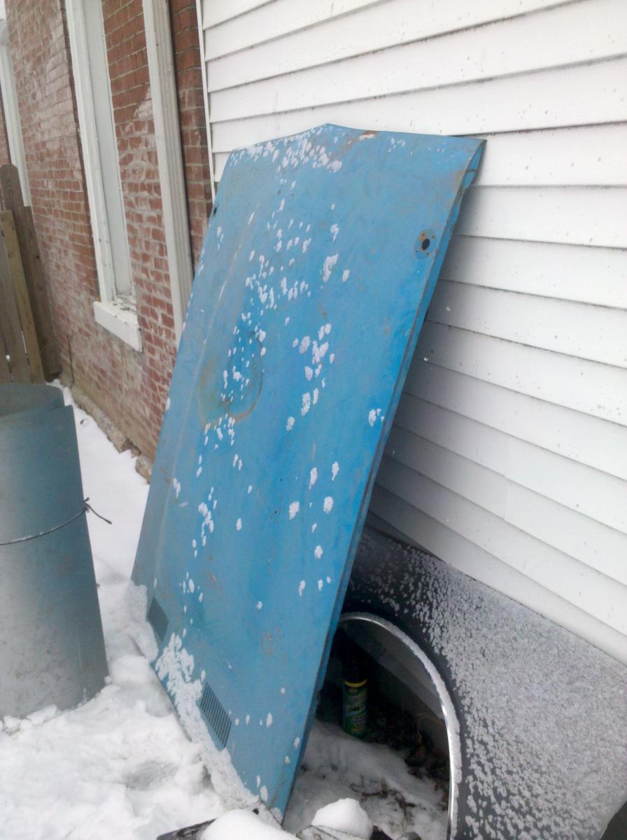

Hood fairy visits...

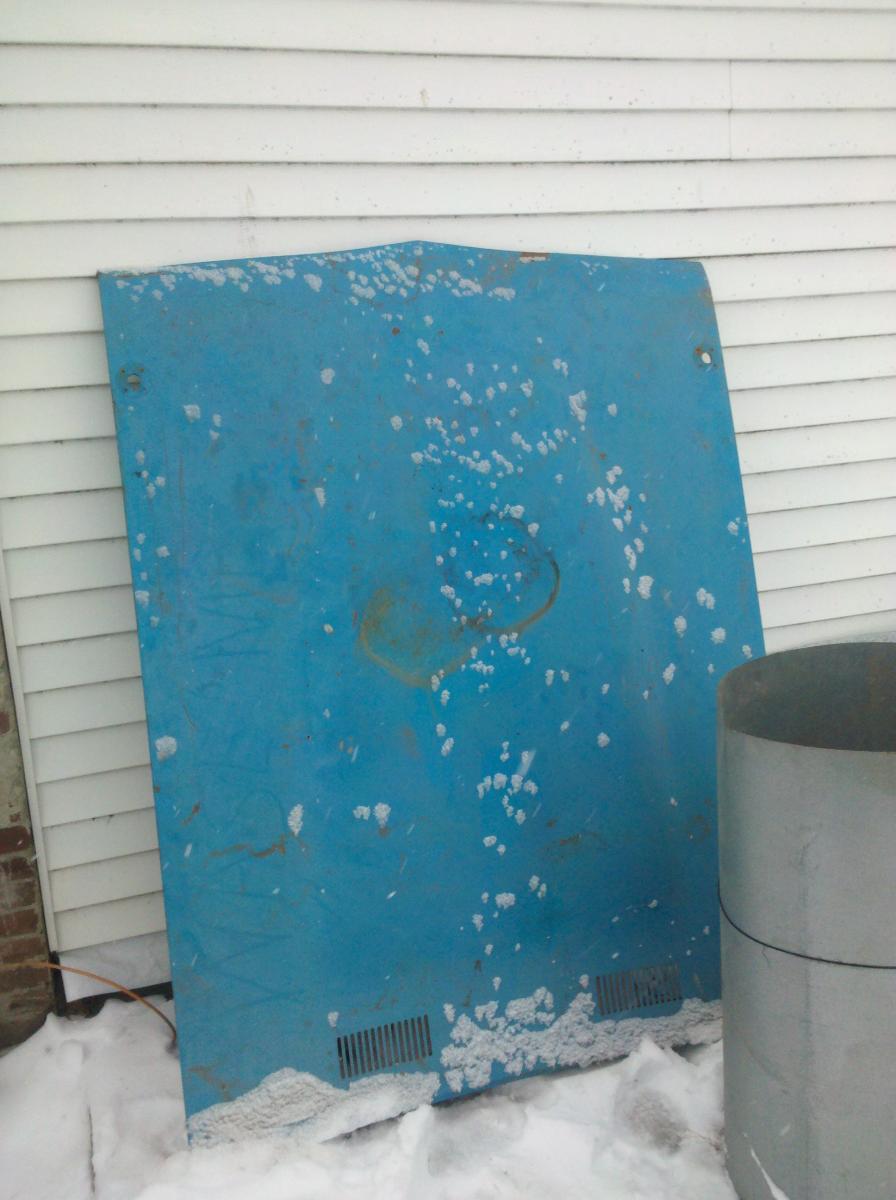

Seems a power bulge hood showed up over night...how'd that get there? Hood fairy...cough cough. Hope they're friends with the spoiler fairy too!
No rust but has a few dents to be worked out...those are stains in middle of hood from something not dents (I thought they were when 1st saw them).
