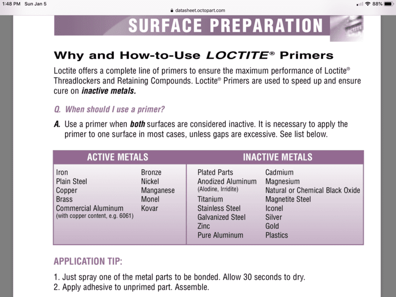

The Loctite primer is a specialized material that is both a degreaser and increases the bond strength of the thread locking compound (like a catalyst, similar to the hardner in an epoxy resin). Loctite type of materials are ANEROBIC based products that cure without the present of air (they do not dry like paint but cure due to a chemicial reaction). This reaction is enhanced by the use of the specified primer. The non use of the primer delays the achievement of total bond strength. Generally most, but not all people, usually dismiss their use because of the additional cost involved. Sometimes, the "my buddy never used it" rule comes into effect. If, however, the disassembly torque was measured against products assembled with and without use of the primer materials, it would be noted more breakaway torque is required for materials assembled with the primer. It is manufactured and noted for a specific reason....it works. Whether you use it or not (the primer) is totally up to you. For my money and equipment, I'll use the primer as recommended.

Good info on the primer Bob.
